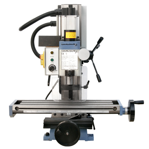

The solid column is much more rigid than the tilting column.
Some people may feel that the tilting column is a feature, but I have used a mini mill for many years and never tilted the column on purpose.
Let's compare the LittleMachineShop.com Solid Column HiTorque Mini Mill to mini mills with a tilting column.
The tilting column on other folk's mini mills tilts 45 degrees from side to side. This has several advantages. First, it is possible to make some angled cuts. It's also easy to tram in the X-axis. One user (and only one) has described to me a cut that was impossible to make any way but using a tilting column.
This mill has a solid column. While it is harder to tram in the X-axis because you must use shims, it is not as easy to knock it out of tram as the tilting column mini mill. The solid column has thicker walls than the tilting column, and a stiffer joint where it joins the base, so the column is significantly more rigid than the tilting column.
LittleMachineShop.com no longer sells mills with a tilting column. That is an indication of how much better the solid column is.
The LittleMachineShop.com HiTorque Mini Mill does not come with a drill chuck as many other mini mills do. That's because the drill chucks provided by the factory do not meet our quality standards (read: they're junk). We had them put the value of the drill chuck into other parts of the mill, like the large X-Y table that is unique to LittleMachineShop.com.

  • Large X-Y table
  • R8 Spindle for wide tool availability
  • Solid column that does not tilt
  • Dovetail column maintains head alignment at any height
  • Fine feed on Z-axis for precise control
  • Three radial handles for drilling
  • E-stop safety power switch
  • Adjustable Z-axis stop for repetitive drilling
  • Neoprene bellows protect horizontal ways
  • Adjustable gibs on all dovetail ways
  • Includes R8 to 33JT drill chuck arbor (no drill chuck)
End Milling Capacity 0.6" (16 mm)
Face Milling Capacity 1.2" (30 mm)
Drilling Capacity 0.5" (13 mm)
Table Size 18.1" x 4.7" (460 mm x 120 mm)
T-slots 3 slots 0.47" (12.0 mm) wide
X-Axis Travel 11.8" (300 mm)
Y-Axis Travel 5.1" (130 mm)
Z-Axis Travel 9.8" (250 mm)
Throat 6.5" (165 mm)
X- and Y-Axis Feed Screws 0.062" (1.59 mm) per rotation
Head Tilt None
Positioning Accuracy 0.0004" (0.010 mm)
Spindle Taper R8
Spindle Motor 0.67 hp (500 Watts)
Spindle Speed 100 - 2500 RPM
Machine Weight 124 lbs (56 kg)
Base Dimensions (W x D) 8.5" x 14.2" (216 mm x 362 mm)
Mounting Holes Center to Center (W x D) 7.00" x 11.88" (177.8 mm x 301.6 mm)
Overall Dimensions (W x D x H) 23.2" x 19.7" x 29.1" (590 mm x 500 mm x 740 mm)
Crated Weight 161 lbs (73 kg)
Crate Dimensions (W x D x H) 23.6" x 24.8" x 27.0" (600 mm x 630 mm x 685 mm)
