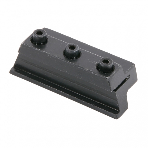

  • Fits Standard 4-way Tool Posts
  • Holds 1/2" Tall Cut-Off Blades
  • Steel Construction
This cut-off, or parting, tool holder fits in the standard 4-way tool post (and most other tool posts) and holds 1/2" tall cut-off blades.
The mini lathe parting tool holder is made of steel and has a 3/8 shank.
Use 3mm hex wrench for screws.

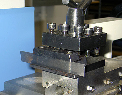

Here's how this cut-off tool holder is used.
Cut-Off Tool Holder Application
