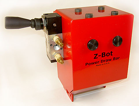

Power Drawbar, R8 Mini Mill
  • Great for CNC mini mills
  • Works with the Tormach tooling system
  • Fits all mini mills with R8 spindle
Part Number: 2936  (Discontinued)
Weight: 8.00 lb
Price: $349.00
The Z-Bot Power Drawbar is a new product developed for the popular Tormach Tooling System.
Installation is simple. Simply drill and tap four holes in the mill head, screw in the spring loaded draw bar, bolt on the power unit, hook up your shop compressor and you are ready to go.
To change a Tormach tool simply flip the lever, insert the tool, and flip the lever again. The entire process takes less than 5 seconds with the power draw bar.
Requires 80 PSI air pressure.
Works with the Belt Drive Conversion Kit, PN 2560.
The Z-Bot Power Drawbar works with the Tormach Tooling System. Z-Bot is developing a tool holder modification program for existing Tormach tooling. This program will cut chamfers on the shank and grooves on the flange of the Tormach tool holders you already have. So if you are thinking about going to Tormach, there's no need to worry about tooling becoming obsolete. Enjoy the benefits of the draw bar now, and then, when you upgrade to the full tool changer, send your holders to Z-Bot to be modified for a modest fee.
The power drawbar is a component of the Z-Bot Automatic Tool Changer. You can install the power drawbar now, and upgrade to the tool changer later. The upgrade kit includes a $50 rebate coupon so there is no extra cost to install the power drawbar now and upgrade to the full automatic tool changer later.
