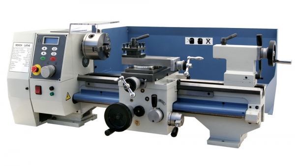

HiTorque 8.5x20 Bench Lathe
  • Inch dials, inch and metric threading
  • 120VAC 60 Hz
  • 1000 Watt (1.34 HP) brushless DC drive
  • Power longitudinal feed and power cross feed
  • 4" (100 mm) 3-jaw self centering lathe chuck
Part Number: 3540  (Discontinued)
Weight: 281 lb
Price: $1,799.95
DISCONTINUED - This HiTorque Mini Lathe has been replaced by the 7500 HiTorque 8.5x20 Deluxe Bench Lathe. All the great features of 3540, plus a new, improved control panel and a heavy-duty splash guard.
View a comparison of the specifications for our lathes.
These machines have genuine NSK bearings. Getting genuine bearings in China is not easy as there are so many fakes around. We had SIEG contact the NSK factory to see where to purchase genuine NSK bearings that they could count on as not being fakes.
The HiTorque 8.5x20 Bench Lathes offer extended threading capabilities. Here's a document that explains how to set the change gears on the HiTorque Bench Lathes.
Here are data sheets for the machines that we sell.
Here are the users guides for the machines we sell.
Features newly updated for the model 7500 lathe
  • 1000 Watt output spindle motor with spindle speed display
  • Genuine NSK bearings
  • Metal gears
  • Induction hardened ways
  • Power cross feed
  • E-stop safety power switch
  • Spindle on-off button
  • Forward/reverse button for spindle and lead screw direction
  • Reversible lead screw allows for right- and left-hand threading
  • Extended threading capability - inch and metric threads
  • Zero-resettable dials graduated at 0.001" and advancing 0.050" per turn
  • Cam-lock tailstock
  • Four-way tool post
Swing Over Bed 8.5" (215 mm)
Swing Over Saddle 4.6" (118 mm)
Distance Between Centers 20" (510 mm)
Spindle Through Hole 0.8" (20 mm)
Spindle Motor Output 1.34 hp (1000 Watts)
Range of Threads 8-80 TPI (0.2-8.0 mm)
Spindle Taper #3 Morse taper
Tailstock Taper #2 Morse taper
Spindle Speed 100 - 2000 RPM
Cross Slide Travel 3.9" (100 mm)
Power Requirements 120 V 60 Hz 12 Amps
Crated Weight 281 lbs (128 kg)
Machine Weight 220 lbs (100 kg)
Overall Dimensions (W x D x H) 40" x 22" x 16" (1010 mm x 550 mm x 400 mm)
Crate Dimensions (W x D x H) 44" x 28" x 22" (1110 mm x 700 mm x 550 mm)
