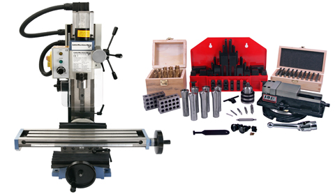

  • Most powerful mill in its class with most low-speed torque in its class
  • Includes tooling package
  • No gears in spindle drive
  • Largest table and X-Y travel in its class
  • R8 spindle (Includes 1/2" drill chuck and arbor)
Part Number: 4218  (Discontinued)
Weight: 220 lb
Price: $1,178.95
HiTorque Mini Mill and Tooling Package. This includes the PN 3900 HiTorque Mini Mill and the PN 3489 R8 Mini Mill Tooling Package and a drill chuck.
The LittleMachineShop.com HiTorque Mini Mill is the best in its class. It has the most power, most torque, and a larger table than other mills in its class.
The 500 Watt brushless spindle drive motor provides tremendous low-end torque. And you can vary the speed from 100 rpm to 2500 rpm continuously. There are no gears to shift. And, with no gears, the HiTorque Mini Mill is the quietest in its class.
The large mill table provides 50% more table area than other mini mills. It also has 30% more travel in each direction. The resettable feed dials allow you to zero them at any point.
The HiTorque Mini Mill has drill press handles for drilling and fast motion of the mill's head. It also has Z-axis fine feed with 0.001" resolution for milling operations.
T-slot cleaners are designed for Bridgeport mills. It takes a few seconds on a grinder to reduce the size of the "T" to fit the slots on the mini mill.The LittleMachineShop.com HiTorque Mini Mill does not come with a drill chuck as many other mini mills do. That's because the drill chucks provided by the factory do not meet our quality standards (read: they're junk). We had them put the value of the drill chuck into other parts of the mill, like the large X-Y table that is unique to LittleMachineShop.com.
Get one of these drill chucks and you will be in business.
Let's compare the LittleMachineShop.com Solid Column HiTorque Mini Mill to mini mills with a tilting column.
The tilting column on other folk's mini mills tilts 45 degrees from side to side. This has several advantages. First, it is possible to make some angled cuts. It's also easy to tram in the X-axis. One user (and only one) has described to me a cut that was impossible to make any way but using a tilting column.
This mill has a solid column. While it is harder to tram in the X-axis because you must use shims, it is not as easy to knock it out of tram as the tilting column mini mill. The solid column has thicker walls than the tilting column, and a stiffer joint where it joins the base, so the column is significantly more rigid than the tilting column.
LittleMachineShop.com no longer sells mills with a tilting column. That is an indication of how much better the solid column is.

End Milling Capacity 0.6" (16 mm)
Face Milling Capacity 1.2" (30 mm)
Drilling Capacity 0.5" (13 mm)
Table Size 18.1" x 4.7" (460 mm x 120 mm)
T-slots 3 slots 0.47" (12.0 mm) wide
X-Axis Travel 11.8" (300 mm)
Y-Axis Travel 5.1" (130 mm)
Z-Axis Travel 9.3" (235 mm)
Throat 6.5" (165 mm)
X- and Y-Axis Feed Screws 0.062" (1.59 mm) per rotation
Head Tilt 45°- 0°- - 45°-
Positioning Accuracy 0.0004" (0.010 mm)
Spindle Taper R8
Spindle Motor 0.67 hp (500 Watts)
Spindle Speed 100 - 2500 RPM
Machine Weight 121 lbs (55 kg)
Overall Dimensions (W x D x H) 23.2" x 19.7" x 29.1" (590 mm x 500 mm x 740 mm)
Shipping Weight 164 lbs (75 kg)
Shipping Dimensions (W x D x H) 23.6" x 23.6" x 29.9" (600 mm x 600 mm x 760 mm)
