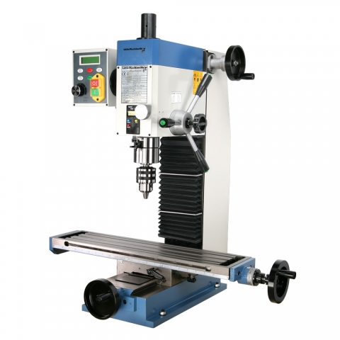

5500 HiTorque Bench Mill 5500 HiTorque Bench Mill

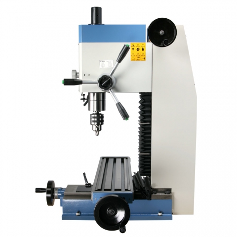

HiTorque Bench Mill Front View Front View

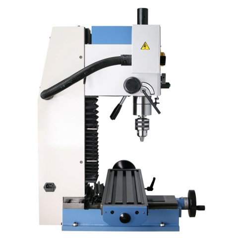

HiTorque Bench Mill Side View Side View

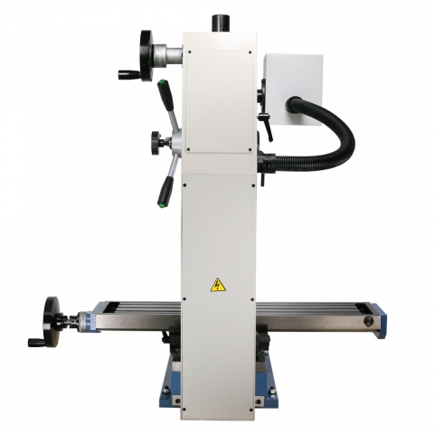

HiTorque Bench Mill Rear View Rear View

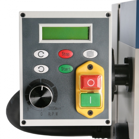

HiTorque Bench Mill Control Panel Control Panel

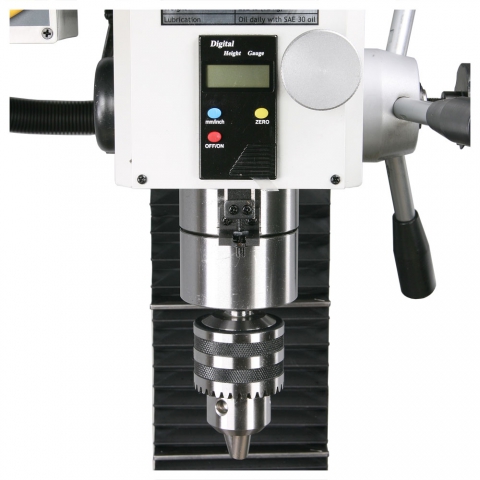

"HiTorque Bench Mill Digital Height Gauge Digital Height Gauge, Fine Feed and Spindle
