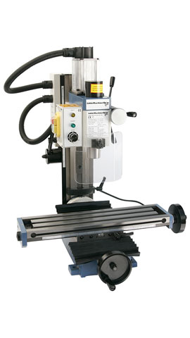

  • Most powerful mill in its class & most low-speed torque in its class
  • No gears in spindle drive
  • Largest table and X-Y travel in its class
  • R8 spindle (Includes R8 to 33JT drill chuck arbor, but no drill chuck)
The LittleMachineShop.com HiTorque Mini Mill is the best in its class. It has the most power, most torque, and a larger table than other mills in its class.
The 500 Watt brushless spindle drive motor provides tremendous low-end torque. And you can vary the speed from 50 RPM to 2500 RPM continuously. There are no gears to shift. And, with no gears, the HiTorque Mini Mill is the quietest in its class.
The large mill table provides 50% more table area than other mini mills. It also has 30% more travel in each direction. The resettable feed dials allow you to zero them at any point.
The HiTorque Mini Mill has drill press handles for drilling and fast motion of the mill's head. It also has Z-axis fine feed with 0.001" resolution for milling operations.
Chris' Tips
The LittleMachineShop.com HiTorque Mini Mill does not come with a drill chuck as many other mini mills do. That's because the drill chucks provided by the factory do not meet our quality standards (read: they're junk). We had them put the value of the drill chuck into other parts of the mill, like the large X-Y table that is unique to LittleMachineShop.com.
Get one of these drill chucks and you will be in business.
Let's compare the LittleMachineShop.com HiTorque Mini Mills.
The model 3900 has a column that tilts 45 degrees from side to side. This has several advantages. First, it is easy to make angled cuts. It's also easy to tram in the X-axis. At least one user has described to me a cut that was impossible to make any way but using a tilting column.
The model 3960 has a solid column. While it is harder to tram in the X-axis because you must use shims, it is not as easy to knock it out of tram as the tilting column mini mill. The solid column has thicker walls than the tilting column, and a stiffer joint where it joins the base, so the column is more rigid than the tilting column.

Features
  • Large X-Y table
  • R8 Spindle for wide tool availability
  • Column tilts 45° either side of vertical
  • Dovetail column maintains head alignment at any height
  • Fine feed on Z-axis for precise control
  • Three radial handles for drilling
  • E-stop safety power switch
  • Adjustable Z-axis stop for repetitive drilling
  • Neoprene bellows protect horizontal ways
  • Adjustable gibs on all dovetail ways
  • Includes R8 to 33JT drill chuck arbor (no drill chuck)
End Milling Capacity 0.6" (16 mm)
Face Milling Capacity 1.2" (30 mm)
Drilling Capacity 0.5" (13 mm)
Table Size 18.1" x 4.7" (460 mm x 120 mm)
T-slots 3 slots 0.47" (12.0 mm) wide
X-Axis Travel 11.8" (300 mm)
Y-Axis Travel 5.1" (130 mm)
Z-Axis Travel 9.3" (235 mm)
Throat 6.5" (165 mm)
X- and Y-Axis Feed Screws 0.062" (1.59 mm) per rotation
Head Tilt 45°- 0° - 45°
Positioning Accuracy 0.0004" (0.010 mm)
Spindle Taper R8
Spindle Motor 0.67 hp (500 Watts)
Spindle Speed 100 - 2500 RPM
Machine Weight 119 lbs (54 kg)
Overall Dimensions (W x D x H) 23.2" x 19.7" x 29.1" (590 mm x 500 mm x 740 mm)
Crated Weight 156 lbs (71 kg)
Crate Dimensions (W x D x H) 23.6" x 23.6" x 29.9" (600 mm x 600 mm x 760 mm)
