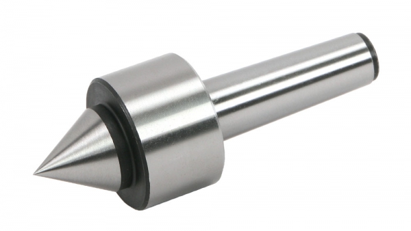

  • Point is a 60 degree included angle
  • Short 2 Morse taper for the mini lathe
  • Fits Jet 1014 mini wood lathe
  • 1.495" diameter body
Part Number: 1189
Weight: 0.74 lb
Price: $23.95
This mini lathe live center fits the tailstock of the mini lathe.
The point is a 60 degree included angle and is 0.71" in diameter.
Use a live center in the tailstock to turn between centers or to support the end of a long workpiece.
In addition to the metal lathes listed below, this live center works on the Jet 1014 mini wood lathe. But get the standard length live center for larger Jet wood lathes like the Jet 1220.
The standard length center linked above is also required for the Grizzly G0765 7x14 lathe.
This product works with lathes with a short 2 Morse taper tailstock taper including:
