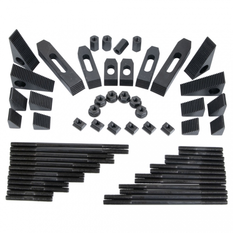

Clamping Kit, 8 mm T-Slot in Organizer Case
  • Stud size: M6
  • T-slot: 8 mm wide at top
  • 58 pieces
  • Made of heat treated steel
  • Organizer case included
Part Number: 1427
Weight: 14.0 lb
$64.95 On Sale
Regularly $69.95
58-piece clamping kit M6, 8-mm T-slot in organizer case.
This machinist clamping kit fits the 8 mm T-slots on the micro mill.
The t-slot clamp kit includes 24 M6 studs, 12 step blocks in pairs, 6 T-slot nuts, 6 flange nuts, 4 coupling nuts, and 6 step clamps.
Comes in an organizer case.
The stated dimension of the clamping kit is the width at the top of the T-slot.
Measure the width at the top of the T-slot as shown in the photo below. This is the dimension given for T-slot nuts and clamping kits. For example, if you measure 0.468 at the top of the T-slot, you should get a 7/16” (0.438”) T-slot nut or clamping kit.
