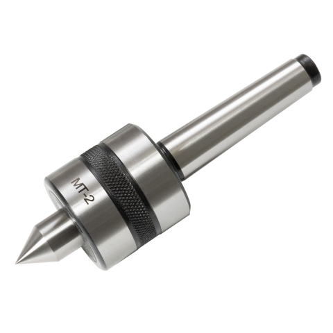

Live Center, 2MT
Live Center, 2MT
  • Hardened steel point is a 60º included angle
  • Standard 2 Morse taper for the mini lathe
  • Body diameter 40mm (1.575")
  • Overall length 148mm (5.83")
  • Recommended for use up to 1500 RPM
Part Number: 1592
Weight: 1.20 lb
Price: $35.95
A live center is a tool used in machine tools to support a long workpiece and reduce flex, preventing chatter and compromised surface finish. It is placed between the headstock and tailstock of a lathe. Unlike a dead center, a live center revolves with the workpiece.
This center is made from hardened steel and ground for accuracy. The point is a 60º included angle.
The overall length is 148mm (5.83"), the point diameter is 21mm (0.827") and the body diameter is 40mm (1.575")
This live center has less runout than our other live center, but it is longer so it reduces the maximum length you can turn.
This product works with lathes with a 2 Morse taper tailstock taper and a short 2 Morse taper tailstock taper including:
