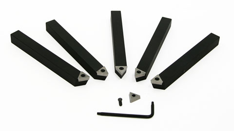

  • 5 piece turning tool set
  • 3/8" square shank 3.5" overall length
  • 6 screws (MS-1153) (5 installed on the bits, 1 extra)
  • T-7 wrench
  • 6 TPMW-222 HSS inserts (5 installed on the bits, 1 extra)
Part Number: 1619
Weight: 1.00 lb
Price: $184.50
PayPal Credit
This Arthur R. Warner Co. precision tool holder kits use high speed steel inserts. Combine the advantages of high speed steel cutting tools with the convenience of indexable tooling.
The kit contains the following:
- 5 Turning bars 3/8 inch shank 3.50 inches overall length
- 6 Inserts (Turning) T-15 High Speed Steel TPMW-222
Relief : 11 degree, IC: 0.250 inch, Thickness: 0.125 inch, Hole: 0.110 inch Top opening: 0.146 inch at 60 degrees, Radius: 0.031 inch
Screws: (6) MS-1153
Wrench: T-7
