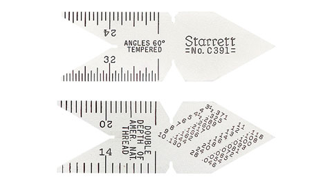

  • Starrett 60 degree center gage
  • Starrett catalog number C391
  • Extremely handy for use in grinding and setting thread cutting tools
  • Spring tempered steel
Part Number: 1829
Weight: 0.02 lb
Price: $30.50
These gages meet the following standards: American National or U.S. 60°, Whitworth or English 55°, and Metric 60°. They also have a very useful scale for finding the number of threads per inch through graduations in 14ths, 20ths, 24ths and 32nds of an inch. The gage also has a table of double depths of threads for determining size of tap drills.
This photo shows how to align a threading tool using the thread gage. You also use the thread gage to check the angle on the threading tool bit.
