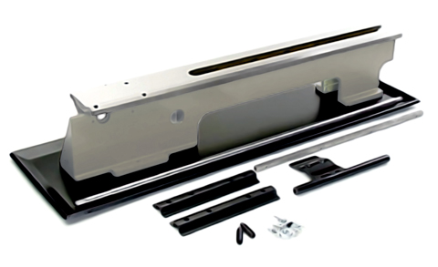

This 14" bed extension kit turns your 7x10 or 7x12 lathe into a 7x14 lathe. It includes a bed casting, a lead screw, a rack, a motor mount, a chip pan, 2 chip pan braces, several fasteners, and complete instructions.
The 7x14 bed is actually 6" longer than the 7x10 bed. It is 2" longer than the 7x12 bed.
This is NOT a bolt-together lathe conversion kit. You must drill and tap 9 holes in the new bed casting to match your lathe. You need three metric taps: M3x0.5, M6x1, and M8x1.25. If you don't have metric drills, you can use letter and number drills for tap drills. (The sizes are given in the instructions.)
This kit comes with complete instructions for installation.
