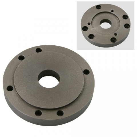

  • Compatible with 5" 3- or 4-Jaw Lathe Chuck with 95 mm Registration Recess
  • Can Use on a Flange for 4" Chuck with 72 mm Registration Boss
  • Works on 8x12 and 8x14 Lathes
Part Number: 2961
Weight: 2.93 lb
Price: $31.00
This adapter mounts a 5" 3- or 4-jaw lathe chuck with a 95 mm registration recess on a flange for a 4" chuck with a 72 mm registration boss. It works on 8x12 and 8x14 lathes as well as the Harbor Freight 5980 multipurpose machine. It also fits the SIEG C4 lathe.
Outside Diameter Ø 4.9" (125 mm)
Center Hole Ø 1.2" (30 mm)
Spindle Side Registration Recess Ø 2.8" (72 mm)
Spindle Side Bold Circle Ø 3.3" (84 mm)
Chuck Side Registration Boss Ø 3.7" (95 mm)
Chuck Side Bolt Circle Ø 4.3" (108 mm)
Chuck Mounting Holes 6
