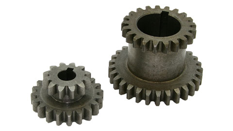

  • Replaces both plastic transmission gears with metal
  • Fits mini lathes and 3MT mini mills
  • Small Gear: 12 Teeth / 20 Teeth, 12 mm Bore, 4 mm Keyway
  • Large Gear: 21 Teeth / 29 Teeth, 30 mm Bore, 5 mm Keyway
Part Number: 3448
Weight: 1.10 lb
$49.95 On Sale
Regularly $67.95
Once this steel gear set is installed on your mini lathe or mini mill, you will no longer have to worry about breaking the hard-to-replace gears inside the headstock.
On the mini lathe, the belt drive ensures that expensive parts don't break from overloads.
On the mini mill, the easy-to-replace intermediate gear on top of the headstock is still plastic. This helps to ensure that you don't break expensive and hard to replace parts.
The smaller in this set is smaller of the two transmission gears. It has 12 Teeth on one end and 20 teeth on the other.
The larger of the two is the larger of the two transmission gears. It has 21 Teeth on one end and 29 teeth on the other.
This product contains the following items:
  Description Qty
Gear, 2-Speed Intermediate Shaft, Metal Gear, 2-Speed Intermediate Shaft, Metal, P/N 3451 1
Gear, 2-Speed Spindle, Metal Gear, 2-Speed Spindle, Metal, P/N 3453 1
