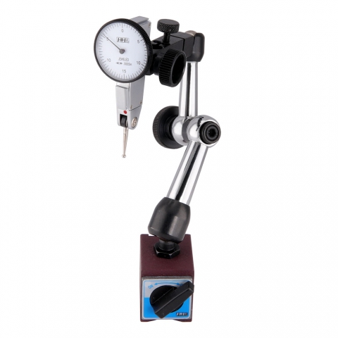

  • Dial test indicator with 0.0005" graduations, range of 0.030" in either direction
  • Unique central locking mechanism on magnetic base locks all motion with one knob
  • Magnetic base has fine adjustment
  • Includes a fitted case
Part Number: 3522
Weight: 1.67 lb
Price: $81.95

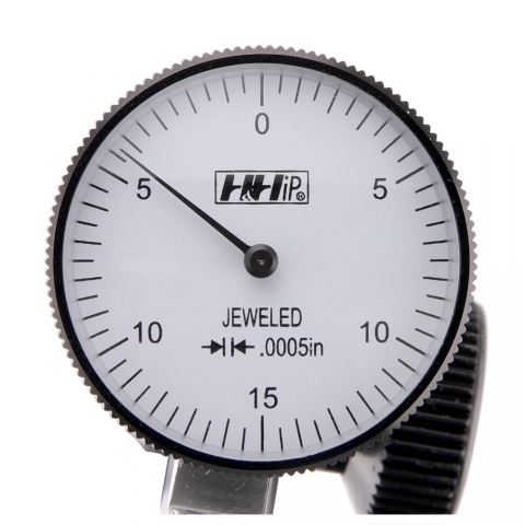

The dial test indicator features a 7 jewel movement. It includes 5/32" and 3/8" diameter posts, dovetails on the back and end, and an 0.080" diameter point. The face is 1.125" in diameter.
This magnetic base is smaller than most; the base is 1.2" by 1.5". The maximum reach is 7". The on/off switch makes it easy to position, while the V-groove base allows you to mount it on cylindrical surfaces.
This magnetic base is the perfect size for mini lathes and mini mills. It accepts dial indicators with 3/8" stems and dial test indicators with dovetails.
Range 0.00" - 0.03" (0.0 mm - 0.8 mm)
Resolution 0.0005" (0.013 mm)
Dial Reading 0-15-0
"Dial Test Indicator Indicator Face
