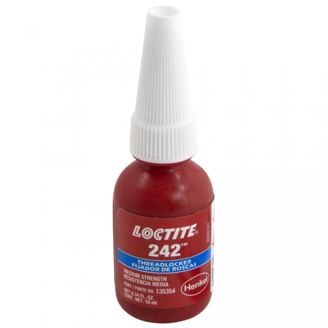

Loctite® 242® Medium Strength Blue Threadlocker is a general purpose, removable threadlocker for fasteners between 1/4" and 3/4" (6 to 20 mm) diameters. Controlled lubricity for accurate clamp loads. Parts can be separated using hand tools.
LOCTITE® 242® is designed for the locking and sealing of threaded fasteners which require normal disassembly with standard hand tools. The product cures when confined in the absence of air between close fitting metal surfaces and prevents loosening and leakage from shock and vibration. Suitable for applications on less active substrates such as plated surfaces, where disassembly with hand tools is required for servicing. The thixotropic nature of LOCTITE® 242 ® reduces the migration of liquid product after application to the substrate.
To assemble threaded fasteners with Loctite:
  1. For best results, clean all surfaces (external and internal) with a LOCTITE® cleaning solvent and allow to dry.
  2. If the material is an inactive metal or the cure speed is too slow, spray all threads with Activator 7471™ or 7649™ and allow to dry.
  3. Shake the product thoroughly before use.
  4. To prevent the product from clogging in the nozzle, do not allow the tip to touch metal surfaces during application.
  5. For Thru Holes, apply several drops of the product onto the bolt at the nut engagement area.
  6. For Blind Holes, apply several drops of the product down the internal threads to the bottom of the hole.
  7. For Sealing Applications, apply a 360° bead of product to the leading threads of the male fitting, leaving the first thread free. Force the material into the threads to thoroughly fill the voids. For bigger threads and voids, adjust product amount accordingly and apply a 360° bead of product on the female threads also.
  8. Assemble and tighten as required.
Disassembly  of Loctite 222 and 242
  • Remove with standard hand tools.
  • In rare instances where hand tools do not work because of excessive engagement length, apply localized heat to nut or bolt to approximately 250 °C. Disassemble while hot.
Loctite Primer is recommended when working with aluminum, black-oxide finishes, cadmium, stainless steel, titanium, and zinc.
