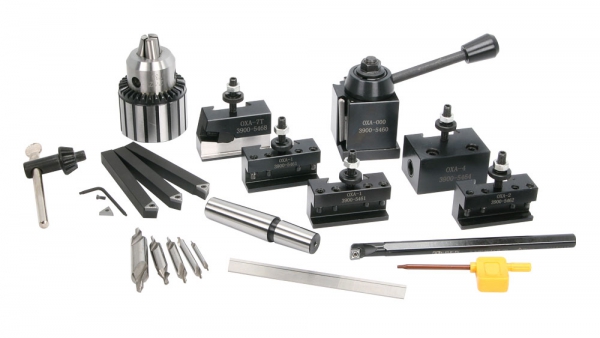

  • Tormach 0XA (Series 000) QCTP set
  • 1/2" professional grade drill chuck, 2MT standard to 33JT drill chuck arbor
  • 3/8"- 6" long Indexable boring bar - CCMT inserts
  • 3/8" indexable TCMT carbide inserts
  • Premium P1 cut-off blade, 5 center drills
Part Number: 4116
Weight: 7.60 lb
$329.95 Value Price
Purchased individually $335.69
This package contains our best versions of all the tooling you need to be productive with your 7x10, 7x12, 7x14, or 7x16 mini lathe.
QCTP: The 0XA (Series 000) quick change tool post features all steel construction and wedge type tool post for better clamping and repeatability. All working parts are hardened and ground. Sealed for maintenance-free operation.
Tool holders designed for mini lathes and other lathes with limited distance from the top of the compound to the center of the lathe. This tool post mounts with an M10 stud, which is included.
This set includes the tool post and the following tool holders:
2 - #1 Turning and Facing
1 - #2 Boring, Turning and Facing
1 - #4 Heavy Duty Boring will hold both 3/8 and 1/2 boring bars
1 - #7 Universal Parting Blade (for 1/2 inch cut-off blade - horizontal)
Drill Chuck: The 1/2" capacity professional grade drill chuck is mounted on a short 2MT shank for the mini lathe. Specifically designed for the mini lathe tailstock, the rated capacity is 1 mm (0.039") to 13 mm (0.512"). All working parts are hardened. Chuck key included. Number 33 Jacobs taper mount. This chuck is comparable to a Jacobs 34-33 heavy duty drill chuck, including the runout specification of 0.004" (0.10 mm) or less.
Indexable Inserts: Indexable turning tools are made by Arthur R. Warner Co. in the USA. These Warner precision tool holder kits use carbide inserts and include three styles of tools, AR right hand, E Neutral (threading tool - 60 degree angle), and AL left hand. Kit includes three tool holders, TCMT inserts, one extra TCMT-21.52 carbide insert, one extra Torx screw, and one wrench.
Boring Bar: This 3/8" diameter indexable boring bar uses CCMT inserts and is 6" long. The minimum bore diameter for this is 0.50". The boring bar takes CCMT 21.51 or CCMT 21.52 inserts.
Cut-Off Blade: The premium P1 parting blade is 1/16" x 1/2" x 4-1/2" and made from M2 HSS by Arthur R. Warner Co. in the USA. These T-shape parting blades provide great side clearance.
Center Drills: Five sizes combined drills and countersinks made of high speed steel. Sizes 1, 2, 3, 4, and 5 with 60 degree counter sinks.
This product is specifically designed for use on the mini lathe tailstock.
