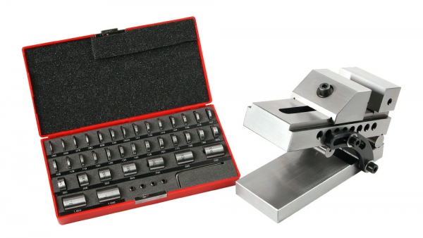

This package includes a 3" Precision screwless sine vise and a 36 piece space block set.
Vise:
Jaw width is 2.9" (73 mm), jaw depth is 1.4" (35 mm), jaw opening is 4" (100 mm). The base size is 7" x 2.9" (190 mm x 73 mm) The center distance of the cylinders is 100.00 mm. Hardened and precision ground to a tolerance of .0004” for both parallelism and squareness. Sine range: 0 - 60°. Jaw can be opened or closed without unbolting vise from work surface.
Block Set:
36 piece block set, use these space blocks to set the sine vise to the correct angle. Working surfaces hardened to Rc 57-60. Four connecting screws are included to make any length desired. Made of precision tool steel and individually marked. Meets or exceeds federal specifications. Set comes in a fitted case.
You can set the Sine Vise to a precise angle using our Space Blocks.
The Sine Vise Height Table shows how to set the sine vise.
