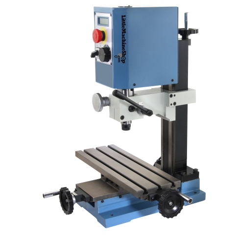

The LittleMachineShop.com HiTorque Micro Mill is the best in its class. It has the most power, the most torque, and a larger table than other mills in its class.
The 250 Watt brushless spindle drive motor provides tremendous low-end torque. And you can vary the speed from 100 rpm to 5000 rpm continuously. There are no gears or belts to shift. And, with no gears, the HiTorque Micro Mill is the quietest in its class.
The large mill table provides 50% more width than other micro mills. The resettable feed dials allow you to zero them at any point.

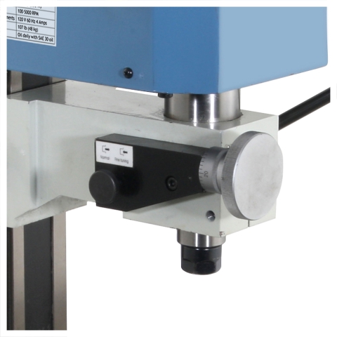

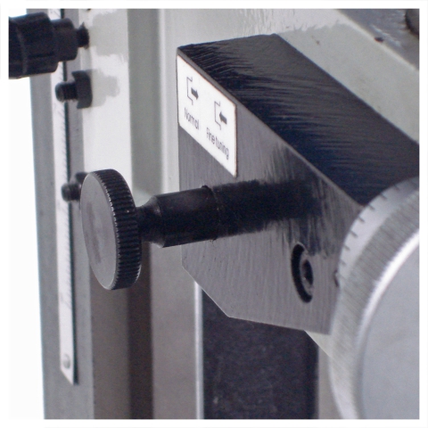

The HiTorque Micro Mill has a drill press handle for drilling. It also has Z-axis fine feed with 0.001" resolution for milling operations.
This is a version of the SIEG SX1P micro milling machine.
You can compare the specifications for our mills.
Here are data sheets for the machines that we sell.

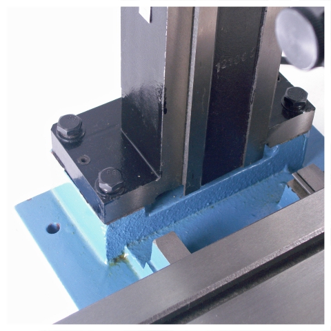

These machines are fully assembled, adjusted, and tested at the factory. Then the column and head is removed from the base so they can ship in two components. This reduces the shipping cost by about half.
When you get the machine, use the four bolts provided to fasten the column to the base and you are ready to go. The manual has complete instructions.
  • 250 Watt output spindle motor
  • Large X-Y table
  • #2 Morse taper spindle
  • Solid column that does not tilt
  • Dovetail column maintains head alignment at any height

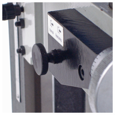

  • Fine feed on Z-axis for precise control
  • Radial handle for drilling

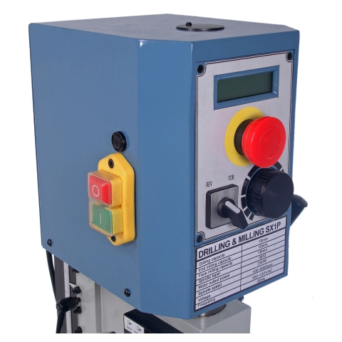

  • E-stop safety power switch

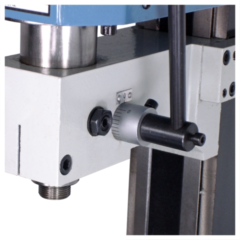

  • Adjustable Z-axis stop for repetitive drilling

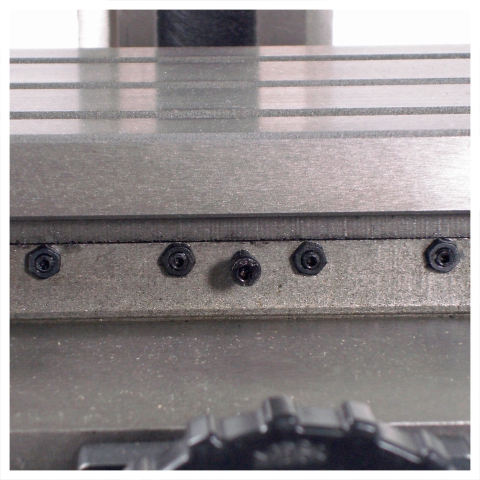

  • Adjustable gibs on all dovetail ways
  • Includes 3/8" capacity drill chuck and arbor

Spindle Motor 0.34 hp (250 Watts)
Spindle Speed 100 - 5000 RPM
Power Requirements 120 V 60 Hz 5 Amps

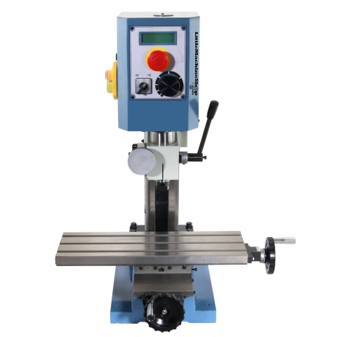

"HiTorque Micro Mill Side View
"HiTorque Micro Mill Alternate Side View

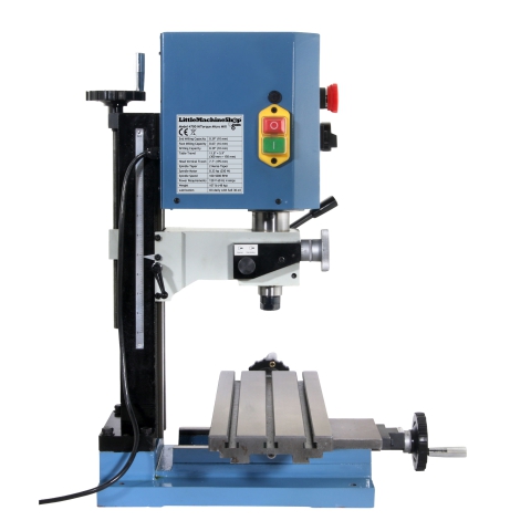

"HiTorque Micro Mill Front View
"HiTorque Micro Mill Headstock

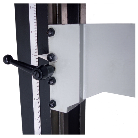

"HiTorque Micro Mill Z-axis Lock Lever
"HiTorque Micro Mill Z-axis Depth Stop
"HiTorque Micro Mill zZ-axis Fine Feed
"HiTorque Micro Mill Z-axis Fine Feed Disengaged
"HiTorque Micro Mill Z-axis Fine Feed Engaged
"HiTorque Micro Mill X-axis Gib Adjustments
"HiTorque Micro Mill Solid Column Base
