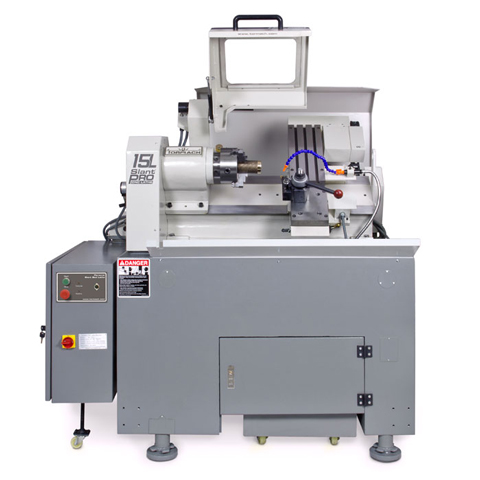

  • 15" Diameter swing over bed
  • 3 HP Spindle (up to 3500 RPM)
  • D1-4 Nose with removable 5C taper Insert
  • 25" Carriage
  • Conversational programming
Part Number: 5045
Weight: 1580 lb
Price: $21,152.00
The Tormach 15L Slant-PRO™ is a compact CNC slant-bed lathe designed for prototyping and light production work. With highly customizable workholding, rigid tapping support, and a host of configurable options and upgrades, the Tormach 15L Slant-PRO™ is a multipurpose CNC lathe for the small shop.
This CNC lathe can be accessorized with a wide array of tool changing and work holding options, including gang, quick change, or fully automatic tool changing, collet closers, etc. The available spindle speed range and horsepower make it well suited to cutting most metals, as well as plastics and non-abrasive composites. Conversational programming screens make this lathe a versatile prototyping tool and easy to program CNC tool. Many part geometries can be programmed on the control without resorting to CAD/CAM.
The Starter Package includes the 15L Slant- Pro Lathe, Manual Oil Pump, Full Enclosure Kit, Lifting Kit, PathPilot Controller, Controller Arm, Waterproof Mini-Keyboard, Cable Kit, Wireless (Wi-Fi) Network Adapter for PathPilot, LCD Monitor, Jog Shuttle Controller, PathPilot Controller Vesa Mount, Waterproof Mouse, Basic 3 Piece Indicator Set, Lathe Tool Starter Kit #1, OD Threading Tool, 1 ER20 Collet Chuck, 15 pc. ER20 Collet Set, Plain Center Drill Set, 1/16 in. - 1/2 in. Jobber Length Drill Bit Set, Quick Change Tool Post Kit, 3-Jaw reversible 6 in. Lathe Chuck, 1 Gallon of Synthetic Coolant, Floating Oil Collection Pillow, and 1 gallon of Machine Way Oil.

  • Cast iron frame
  • 15" Swing over bed diameter
  • Onboard Conversational Programming Interface
  • Native 5C Spindle. A removable taper insert provides up to 1.4" spindle bore
  • D1-4 Spindle Nose; accepts D1-4 cam-lock lathe chucks
  • Extra Long 24.5" Carriage; Supports QC Tool Post, Gang, and Turret Tooling
  • Rigid Tapping Support
  • 3500 RPM Spindle
  • 12 mos. factory warranty
Swing Over Bed 15" (381 mm)
Swing Over Saddle 6.2" (157 mm)
Spindle Through Hole 1.4" (36 mm)
Spindle Motor Output 3 hp (2237 Watts)
Spindle Taper 5C
Spindle Nose D1-4
Spindle Speed 50 - 3500 RPM
Carriage Travel (X, Z) 10" x 12" (254 mm x 305 mm)
Power Requirements 240 V 60 Hz
Power (Secondary) 120 V 60 Hz
Crated Weight 1580 lbs (718 kg)
Overall Dimensions (W x D x H) 58" x 29" x 66" (1473 mm x 737 mm x 1676 mm)
Crate Dimensions (W x D x H) 65" x 37" x 65" (1651 mm x 940 mm x 1651 mm)
