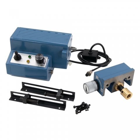

Power table feed for the the SIEG X2 class of mini mills (small table) including Harbor Freight 44991 and Grizzly G8689.
This power feed mounts on the left end of the mini mill's table and drives the X-axis feed screw. It is variable speed (0 to 20 inches per minute).
The mini mill power feed kit takes about two hours to install. The power feed unit bolts to existing bolt holes in the left end of the table. The limit switch mechanism is mounted to the back of the mill table. The power feed adds 8 1/4" inches to the left end of the table.
This mini mill power feed kit fits any mini mill with an extended X-axis feed screw. Look under the left side of the table to see if the X-axis feed screw has a 2 1/2" long unthreaded extension with a slot in the end. If so, you can use this power feed kit.
The x-axis power feed works on 120-240V 50-60Hz power. It has a computer-style (IEC 60320 C3/C4) power cord that unplugs from the power supply unit. This makes it easy to adapt for other countries. The furnished power cord has a North American (NEMA 5-15P) wall plug.

HiTorque Mini Mill Power Feed
Main controller panel with clutch controller (inset).
Limiter switch box with T-Blocks equipped with adjustable pin shafts.
