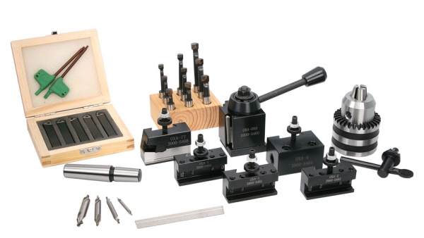

This package contains all the tooling you need to be productive with your 7x10, 7x12, 7x14 or 7x16 mini lathe on the first day you own it.
The 0XA quick change tool post set (QCTP).
This mini lathe tool set includes the tool post and the following tool holders:
2 - #1 Turning and Facing
1 - #2 Boring, Turning and Facing
1 - #4 Heavy Duty Boring will hold both 3/8 and 1/2 boring bars
1 - #7 Universal Parting Blade (for 1/2 inch cut-off blade - horizontal)
The wedge type quick change tool post is made of steel and all working parts are hardened and ground. No tools are required to change tools. Additional tool holders are available.
The turning tool holders accept tools with 1/4" to 1/2" shank. The boring tool holder accepts boring bars with 3/8" or 1/2" round shanks. The cut-off tool holder holds 1/2" tall parting blades.
The 1/2" capacity drill chuck includes a 2 Morse taper shank arbor for the mini lathe. This chuck is specifically designed for the mini lathe tailstock. The rated capacity of the drill chuck is 1 mm (0.039") to 13 mm (0.512").
The set of indexable turning tools includes 5 tools (TAR, TAL, TBR, TBL, TE), inserts, a wrench, and extra screws. It comes in a wooden case. The carbide inserts are TCMT21.51.
The carbide tipped 9-piece boring bar set includes three different length boring bars each for minimum bores of 5/16", 3/8", and 7/16". The bore depth ranges from 3/4" to 2-1/4". The heat treated, alloy steel shanks are held to 0.000 to -0.0005" from the nominal diameter.
The P1 parting blade is 1/16" x 1/2" x 4-1/2" and made from M2 HSS. These T-shape parting blades provide great side clearance.
This package includes 4 different sizes of combined drills and countersinks, commonly called center drills. The center drill set is high speed steel and includes sizes 1, 2, 3, and 4. These are 60 degree center drills. These are the sizes that are most used by bench top machinists.
