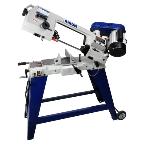

  • Floor standing band saw
  • Horizontal position for precise cutting and automatic shutoff
  • Vertical position for freehand cutting
  • 3 blade speeds
  • 4" x 6" capacity
Part Number: 5300
Weight: 135 lb
$389.95 On Sale
Regularly $449.95
This 4" x 6" capacity horizontal / vertical band saw has automatic shutoff at the end of the cut when in the horizontal position. The saw is floor standing on the included stand.

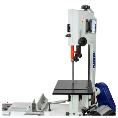

The vertical position allows for freehand cutting of large, thin work pieces.

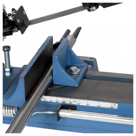

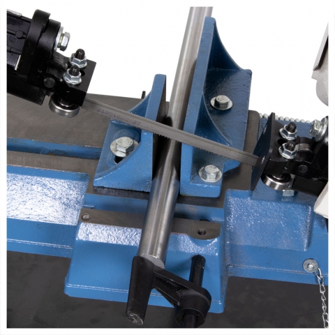

In the horizontal position the vise can be set from 90 to 45 degrees for angle cuts. The saw has adjustable down pressure and automatic shutoff for unattended operation. There is a work stop for repetitive cuts at the same dimension.
The saw comes equipped with a 14 TPI blade.

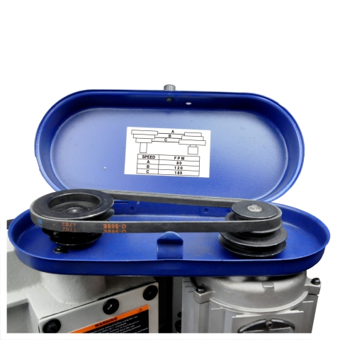

Our 4x6 band saw has three speeds. Use low speed for high strength steel, stainless steel, and other harder materials. Use the medium steel for mild steel including structrual shapes. Use high speed for aluminum and other non-ferrous metals. High speed works well for wood and plastic, too.structural

Cutting Capacity, Rectangular 4" x 6" (102 mm x 152 mm)
Cutting Capacity, Round 5" (127 mm)
Blade Size 64-1/2" x 1/2" x 0.025"
Angle Cuts, Horizontal Position 90°-45°
Motor 0.74 hp (550 Watts)
Blade Speeds 88 130 210 FPM
Power Requirements 120 V 60 Hz 6 Amps
Machine Weight 128 lbs (58 kg)
Base Dimensions (W x D) 34.0" x 14.0" (864 mm x 356 mm)
Overall Dimensions, Horizontal Position (W x D x H) 37.8" x 19.7" x 37.8" (960 mm x 500 mm x 960 mm)
Overall Dimensions, Vertical Position (W x D x H) 37.8" x 19.7" x 55.1" (960 mm x 500 mm x 1400 mm)
Crated Weight 134 lbs (61 kg)
Crate Dimensions (W x D x H) 39.6" x 15.0" x 15.2" (1007 mm x 382 mm x 385 mm)
