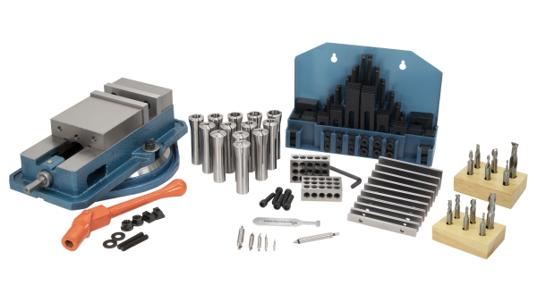

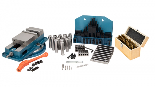

  • 5" Precision milling, professional and 10 pairs of thin parallels
  • Thirteen piece R8 collets, 12 piece End Mill Set - 2 and 4 Flute Cobalt (6 each)
  • 58 - piece clamping kit - 3/8"-16, 7/16" T-slots
  • Premium precision 1-2-3 blocks, five center drills - 60° countersinks
  • Combination edge and center finder and a T-slot cleaner
Part Number: 5535
Weight: 99.1 lb
$749.95 Value Price
Purchased individually $796.50
Premium tooling package with all the best products for your R8 large mini mill.
Milling Vise: Precision 5" Kurt-style milling vice. The top, bottom of vise bed, gib, jaws, swivel base, and all plate mounting surfaces are ground. The jaws are hardened and ground. The fixed jaw is bolted from the top for enhanced rigidity.
The jaws are 5" wide, 1.58" deep and open 5.71".
Without the swivel base, the ways of the precision milling vise are parallel to the base of the vise within 0.0006" in 4". The jaws are perpendicular to the ways within 0.002" in 4". With the swivel base installed, the ways of the vise are parallel to the base of the vise within 0.0008" in 4".
Thin Parallels: Set of ten pairs, 1/8" thick. Made of high-grade alloy steel hardened to 52-58 Rc, parallel within 0.0003" on top and bottom. Parallel heights: 1/2", 9/16", 5/8", 11/16", 3/4", 13/16", 7/8", 15/16", 1", 1-1/16" (pairs matched within 0.0003").
End Mills: 12 piece End Mill Set - 2 and 4 Flute Cobalt (6 each).
R8 Collets: 13 R8 round collets sizes 1/8" to 1" by 16ths. Made of high grade tool steel, hardened and ground to a TIR of 0.0005" or less. This set includes all the sizes required for common end mills.
1-2-3 Blocks: Premium precision 1-2-3 blocks, ground and case hardened on all sides to 55-60 Rc. Blocks are 1" x 2" x 3"; parallel, flat, and square within 0.0001". Set includes two matched blocks and 5 cap screws. Blocks have 23 holes, five are threaded 3/8"-16 NC.
Center Drills: Five piece M42 8% cobalt combined drills and countersinks sizes 1, 2, 3, 4, and 5 with 60 degree counter sinks.
Combined drills and countersinks, commonly called center drills, are used to produce a center hole on a workpiece for turning between centers. Center drills are also used to start drilled holes. Because they are very stiff they don't have a tendency to wander.
