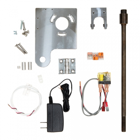

  • Makes tool changes easier, faster, and more convenient
  • Frees up both hands for making tool changes.
  • Electro-magnetic interlock disables power to the motor with the fork of the Spindle Brake engaged.
  • Fits 5500 HiTorque Bench Mills
  • Made in precision machining centers in the U.S.A.
Part Number: 5655
Weight: 2.00 lb
Price: $128.00
PayPal Credit
The Spindle Brake provides a convenient method of locking the spindle freeing both hands to complete a tool change. A safety switch ensures that power to the motor is disabled when the Spindle Brake is engaged. This Spindle Brake features an integral flip-style locking fork which locks the mill’s spindle when engaged and does not require a separate locking device to be mounted and removed from the mill.
To operate, flip the Spindle Brake fork down over the spindle while the spindle is at rest. Then rotate the spindle by hand until the set screws in the Spindle Brake fork mesh with a spindle spline. Once the tool change is complete, lift the Spindle Brake fork up into the retracted position and you are ready to go.
Here are the Spindle Lock installation instructions.
  • Integral Safety Switch
  • Approximate dimensions and weight: 5.75l x 3.75w x 1.38"h, 2 lbs.
  • The Spindle Brake plate, block, and fork are made of 6061-T6511 Aluminum
  • The hinge and fasteners are made of Stainless Steel
  • Made to exacting specifications in precision machining centers in the USA
