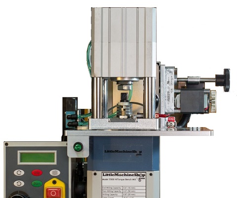

  • Activation with the flip of a switch
  • Provides a consistent holding force of approximately 40 foot-pounds at 90 psi.
  • Safety activation/lockout feature.
  • Does not place a load on the spindle bearings
  • System easily swivels out of the way for manual drawbar operations.
Part Number: 5835

The Priest Tools Power Drawbar is a CNC-class drawbar system that automates the task of loosening and tightening the drawbar when changing a tool on a milling machine. This greatly expedites the tool changing process and adds a great deal of convenience.
Installation requires very slight modification to the mill (drill one small hole). It works with mills that have a quill and is compatible with the following milling machines:

Simple to Use - Insert the actuator plate into the cylinder plate and release the spring plunger that locks it into place. Then flip the switch up to activate the system and remove the tool from the collet. Insert another tool into the collet, and then flip the switch down to dis-engage the Power Drawbar and secure the tool for machining.
Requires a 90 PSI air supply. (You furnish the air compressor.)
