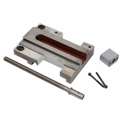

This kit adds one inch to the travel of the cross slide on 7x12, 7x14, and 7x16 mini lathes with the SIEG DRO mounted. These are SIEG C2 and C3 lathes.
The increased travel is away from the centerline of the lathe so you can work on larger diameter work pieces.
This kit replaces the saddle and the cross slide feed screw, and it includes a spacer for the longer screw.
This kit comes with complete instructions for installation.
