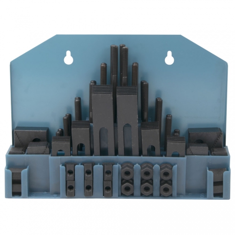

58-piece clamping kit 3/8"-16, 7/16" T-Slot.
This professional grade clamping kit is manufactured at a world class factory that produces high quality US brands. Pieces are made of IC45e steel for improved strength and all parts are case hardened or heat treated to HRC30-40.
The T-slot clamp kit includes:
24 Studs (3/8"-16) - 4 each 3" 4" 5" 6" 7", and 8"
- 4 Coupling nuts
- 6 Flange nuts
- 6 Forged steel step clamps
- 6 T-slot Nuts
- 12 Step blocks in pairs
- 1 Wall Rack
This machinist clamping kit fits the 12 mm T-slots on the mini mill.
The stated dimension of the clamping kit is the width at the top of the T-slot.
Measure the width at the top of the T-slot as shown in the photo below. This is the dimension given for T-slot nuts and clamping kits. For example, if you measure 0.468 at the top of the T-slot, you should get a 7/16” (0.438”) T-slot nut or clamping kit.
