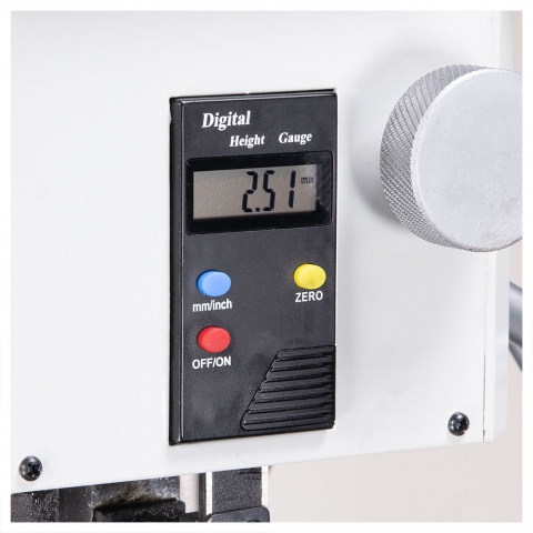

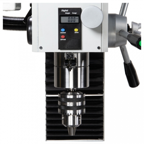

A digital spindle speed display and a separate digital depth gauge for the quill which reads in inches and mm. You can automatically resume running at the last-used spindle speed. Spindle fine feed and position lock are also standard.

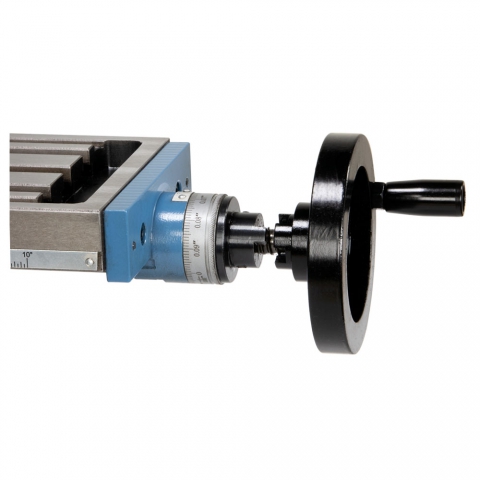

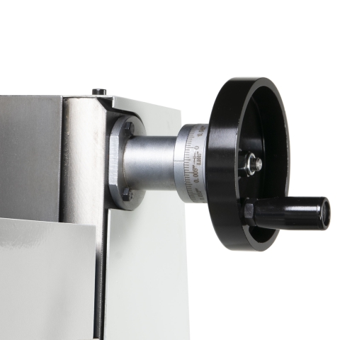

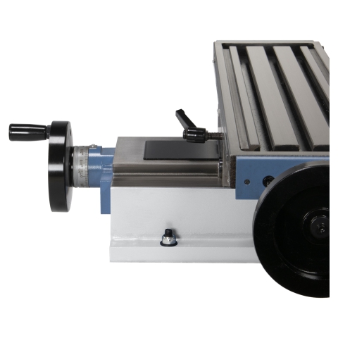

Large anodized handwheels on the X and Y axes and 10 TPI lead screws (accurate to 0.001") provide accurate readings. Ball thrust bearings on feed screws ensure smooth movement.

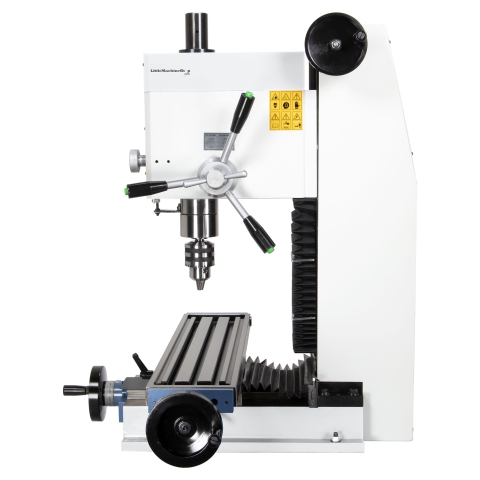

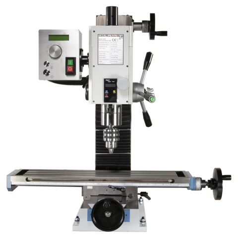

HiTorque Bench Mill - Front View Front View

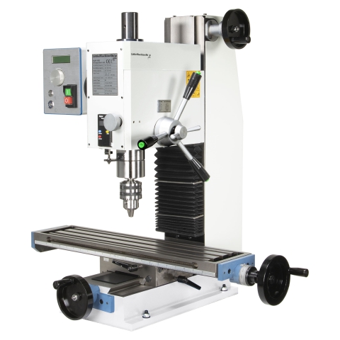

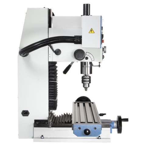

HiTorque Bench Mill - Side View Side View
HiTorque Bench Mill - Digital Height Gauge and Spindle Digital Height Gauge, Spindle, and Fine Feed Control

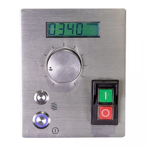

HiTorque Bench Mill - Control Panel Control Panel
HiTorque Bench Mill - X-Axis Hand Wheel X-Axis Hand Wheel
HiTorque Bench Mill - Y-Axis Hand Wheel Y-Axis and Wheel
HiTorque Bench Mill - Z-Axis Hand Wheel Z-Axis Hand Wheel
HiTorque Bench Mill - Digital Height Gauge Digital Height Gauge
