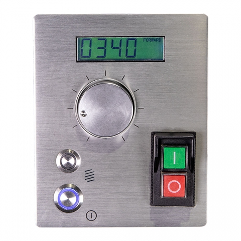

A 750 watt (1 hp) brushless DC motor provides abundant spindle power and tremendous low-end torque and the motor has built in forward and reverse modes easily switched from the power panel.

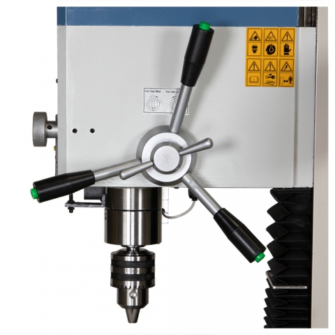

The HiTorque Bench Mill incorporates a true quill and drill press-style handles for easy drilling. A button on the end of each handle reverses the spindle to make tapping easy.
The control panel includes a digital spindle speed display.

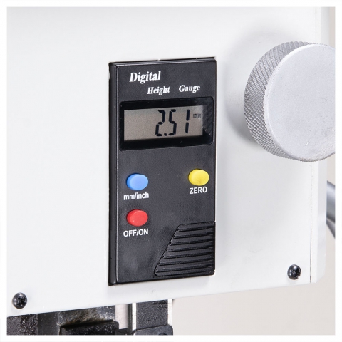

  • Digital position readout on the quill reads in inches and mm

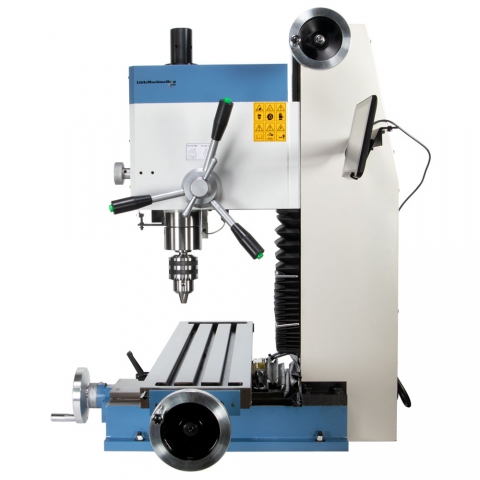

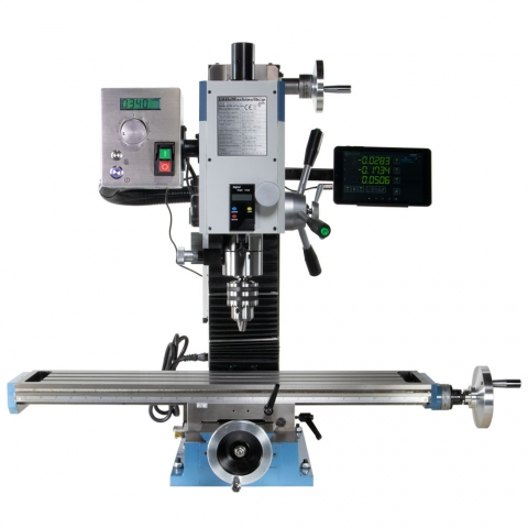

Deluxe HiTorque Bench Mill Long Table - Front View Front View

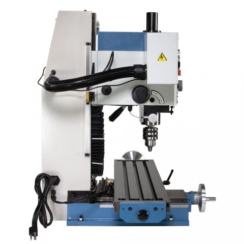

Deluxe HiTorque Bench Mill Long Table - Side View Side View

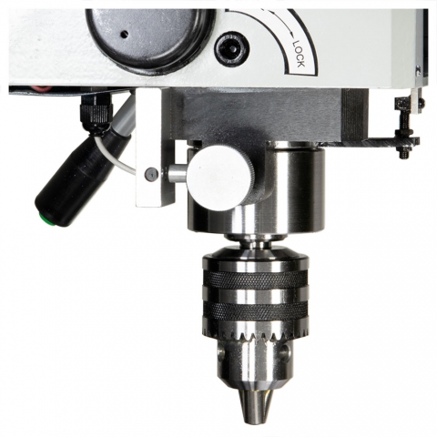

Deluxe HiTorque Bench Mill Long Table - Z-Axis Handle and Spindle Z-Axis Handle and Spindle

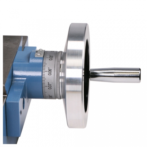

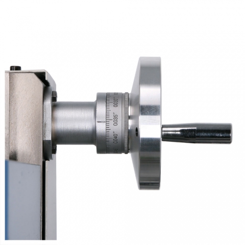

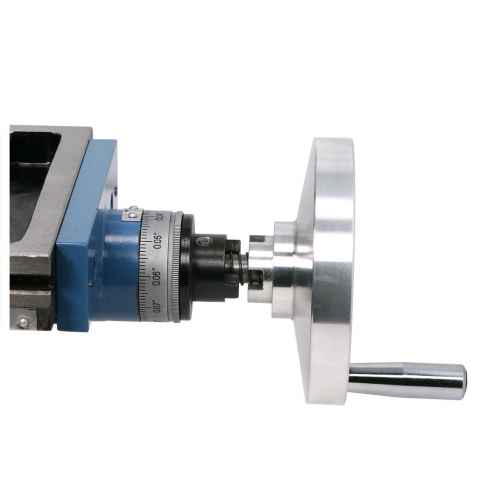

Deluxe HiTorque Bench Mill Long Table - X-Axis Aluminum Hand Wheel X-Axis Aluminum Hand Wheel
Deluxe HiTorque Bench Mill Long Table - Y-Axis Aluminum Hand Wheel Y-Axis Aluminum Hand Wheel
Deluxe HiTorque Bench Mill Long Table - Z-Axis Aluminum Hand Wheel Z-Axis Aluminum Hand Wheel

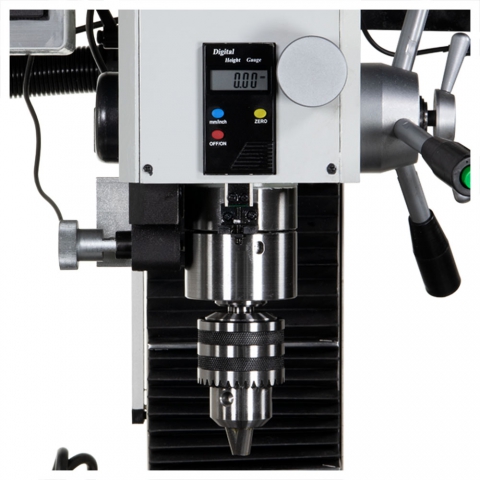

Deluxe HiTorque Bench Mill Long Table - Digital Height Gauge - Fine Feed - Spindle Digital Height Gauge, Fine Feed, and Spindle
Deluxe HiTorque Bench Mill Long Table - Digital Height Gauge Digital Height Gauge
Deluxe HiTorque Bench Mill Long Table - Electrically Interlocked Spindle Lock Electrically Interlocked Spindle Lock

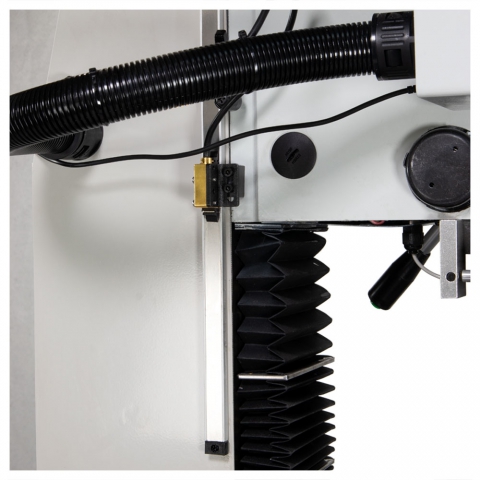

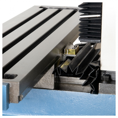

Deluxe HiTorque Bench Mill Long Table - X-Axis DRO Scale and Reader X-Axis DRO Scale and Reader
Deluxe HiTorque Bench Mill Long Table - Y-Axis DRO Scale and Reader Y-Axis DRO Scale and Reader
Deluxe HiTorque Bench Mill Long Table - Z-Axis DRO Scale and Reader Z-Axis DRO Scale and Reader
Deluxe HiTorque Bench Mill Long Table - Control Panel Control Panel
