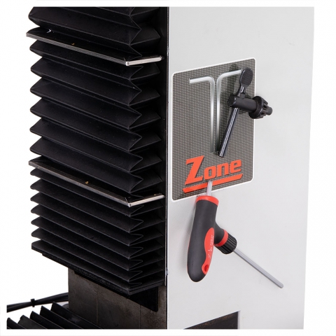

The mill has a solid head and rectangular dovetail column which maintains head alignment at any height, ensuring years of rigid and "true" milling. A handy magnetic "toolbox" on the side of the column provides a convenient place for the spindle wrench and drawbar wrench.

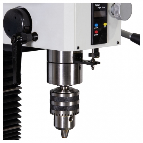

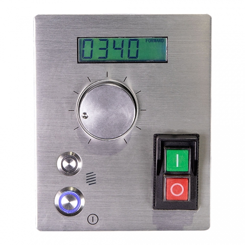

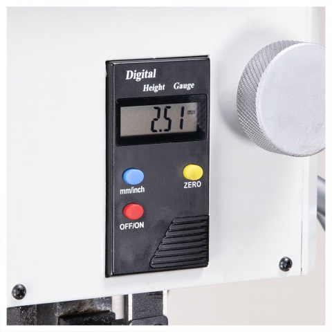

Standard features include a digital spindle speed display and a separate DRO for the quill which reads in inches and mm. You can automatically resume running at the last-used spindle speed. Spindle fine feed and position lock are also standard.

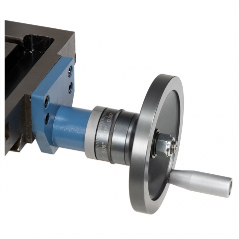

Large anodized handwheels on the X and Y axes and 10 TPI lead screws (Accurate to .001″) provide better accuracy readings than metric conversions. Ball thrust bearings on feed screws and split nuts on X and Y axes minimize backlash and ensure much smoother movements and less backlash.

  • Digital position readout on the quill reads in inches and mm

  • Spindle speed display on control panel

  • Magnetic "tool zone" on column for storing drawbar wrench

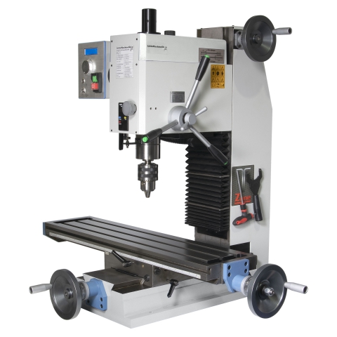

HiTorque Large Bench Mill - Left Side Left Side

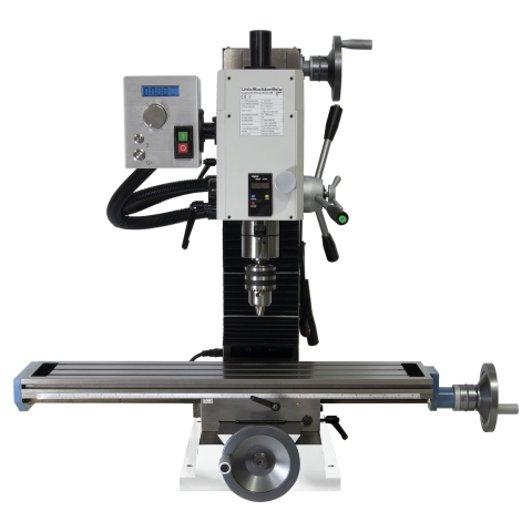

HiTorque Large Bench Mill - Front View Front View

HiTorque Large Bench Mill - Quill digital readout Quill digital readout
HiTorque Large Bench Mill - Control panel Control Panel
HiTorque Large Bench Mill - X-axis hand wheel X-axis hand wheel
HiTorque Large Bench Mill - Magnetic tool zone Magnetic tool zone
