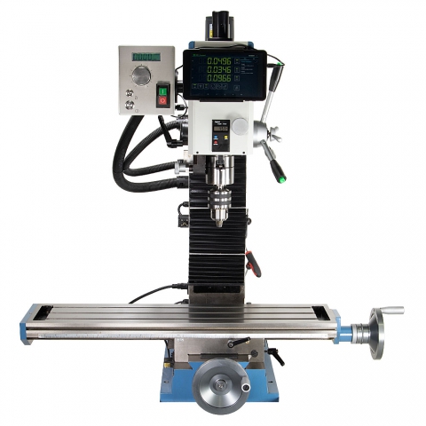

The LittleMachineShop.com HiTorque Large Bench Mill 6750 is our largest mill -- a significant step up in size, rigidity, and power compared to a mini mill, or even our other bench mills. This bench top mill provides a larger table, more travel, more horsepower, and more rigidity. Compare our standard features and specs to others.
The LittleMachineShop.com model 6750 HiTorque Deluxe Large Bench Mill has all the features of the model 6700 HiTorque Large Bench Mill, plus:
* 3-axis digital readout (DRO) with factory-installed magnetic scales, Bluetooth transceiver, and 7" tablet display
* Electrically interlocked spindle lock for easy, safe tool changes

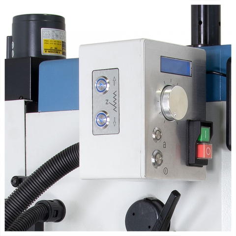

* Power head lift to raise or lower the mill head with the touch of a button
Standard features include:
A 1000 Watt (1-1/3 hp) brushless DC motor provides abundant spindle power and tremendous low-end torque. NSK brand Japanese-quality spindle bearings ensure years of quiet operation. A belt drive from motor to spindle eliminates any failure from gears breaking. A simple belt change switches between low range and high range, giving you continuously variable spindle speeds from 80-5000 rpm.
The combination of a large table (29.1" x 7.1") and extensive travel along all axis (XYZ: 20.2", 8.5", 11.8") provides a large work envelope. Precision ground ways ensures smooth and accurate movement. Adjustable gibs are on all dovetail ways. Fine feed on Z-axis for precise control
The mill has a solid head and rectangular dovetail column which maintains head alignment at any height, ensuring years of rigid and "true" milling. A handy magnetic "toolbox" on the side of the column provides a convenient place for the spindle wrench and drawbar wrench.
The mill has an R8 spindle for wide tool availability. A true quill and drill press-style handles makes for easy drilling. Tapping-mode is another standard feature with a button on the end of each handle allowing you to reverse the spindle to make tapping easy.

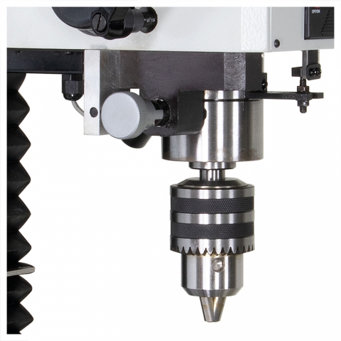

Standard features include a digital spindle speed display and a separate DRO for the quill which reads in inches and mm. You can automatically resume running at the last-used spindle speed. Spindle fine feed and position lock are also standard.

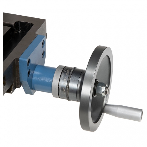

10 TPI lead screws with large anodized handwheels on the X and Y axes. Accurate .001″ readings provide better accuracy than metric conversions. Ball thrust bearings on feed screws and split nuts on X and Y axes minimize backlash and ensure much smoother movements and less backlash.
We stand behind every machine we sell. If it’s not right, we’ll make it right and we have the in-house technicians and replacement parts in our U.S. warehouse to back it up.
*This mill is a version of the SIEG SX3.5 built to LittleMachineShop.com specifications.
**WARNING: At over 350 pounds, you and your buddies can't lift this onto your bench. You will need an engine hoist, forklift, or other mechanical assist to move this machine.

6750 HiTorque Deluxe Large Bench Mill features:
  • Factory-installed 3-axis digital position readout (DRO) with Bluetooth connection and 7" tablet display
  • Power head lift raises or lowers the mill head with the touch of a button
  • Electrically interlocked spindle lock for easy, safe tool changes
Plus all the features of the 6700 HiTorque Large Bench Mill
  • 1000 Watt (1-1/3 hp) brushless DC spindle drive
  • R8 Spindle for wide tool availability
  • NSK brand Japanese-quality spindle bearings
  • 0.001" graduated dials, 0.100" per turn
  • Digital position readout on the quill reads in inches and mm
  • Resume running at last-used spindle speed
  • Tapping mode for backing taps out and for running in reverse direction
  • Solid rectangular column for rigidity
  • Dovetail column maintains head alignment at any height
  • Large 29.1" x 7.1" (740 mm x 180 mm) X-Y table with anodized handwheels
  • E-stop safety power switch

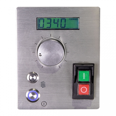

  • Spindle speed display on control panel
  • Spindle fine feed and position lock
  • Fine feed on Z-axis for precise control
  • Adjustable gibs on all dovetail ways
  • Includes R8 to 33JT drill chuck arbor and drill chuck

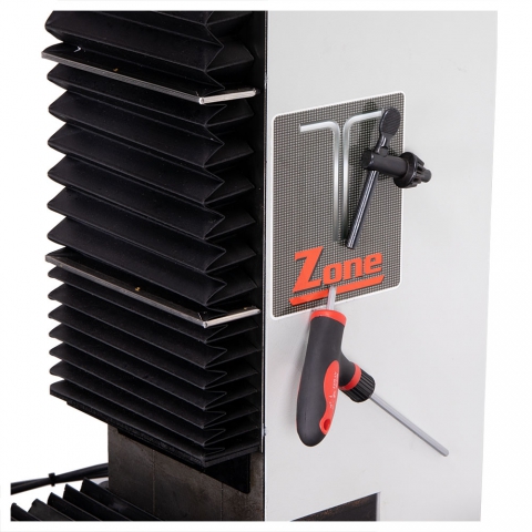

  • Magnetic "tool zone" on column for storing drawbar wrench
End Milling Capacity 0.8" (20 mm)
Face Milling Capacity 3.0" (75 mm)
Drilling Capacity 1.2" (30 mm)
Table Size 29.1" x 7.1" (740 mm x 180 mm)
T-Slots 3 slots 0.47" (12.0 mm) wide
X-Axis Travel 20.2" (513 mm)
Y-Axis Travel 8.5" (215 mm)
Z-Axis Travel 9.8" (250 mm)
Throat 9.1" (230 mm)
X- and Y-Axis Feed Screws 0.100" (2.54 mm) per rotation
Quill Travel 3.1" (78 mm)
Maximum Spindle to Table 13.4" (340 mm)
Positioning Accuracy 0.0004" (0.010 mm)
Spindle Taper R8
Spindle Motor 1.34 hp (1000 Watts)
Spindle Speed, Low Range 80 - 1500 RPM
Spindle Speed, High Range 280 - 5000 RPM
Power Requirements 120 V 60 Hz 14 Amps
Machine Weight 352 lbs (160 kg)
Base Dimensions (W x D) 11.0" x 20.1" (280 mm x 510 mm)
Mounting Holes Center to Center (W x D) 10.00" x 14.17" (254.0 mm x 360.0 mm)
Overall Dimensions (W x D x H) 37.0" x 30.5" x 36.5" (940 mm x 775 mm x 927 mm)
Crated Weight 412 lbs (187 kg)
Crate Dimensions (W x D x H) 37.5" x 32.7" x 42.0" (952 mm x 831 mm x 1067 mm)

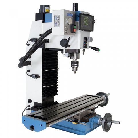

HiTorque Deluxe Large Bench Mill – Left Side Left Side
HiTorque Deluxe Large Bench Mill – Front View Front View

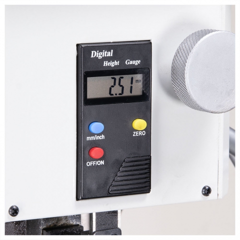

HiTorque Deluxe Large Bench Mill - Quill digital readout Quill digital readout
