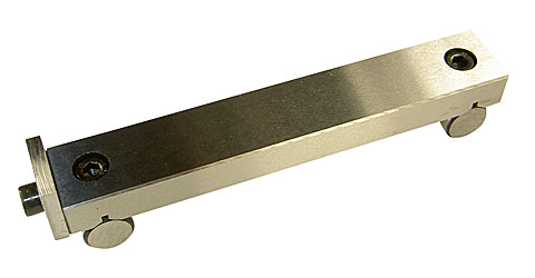

Sine Bar, 5"
Sine Bar, 5"
  • Working face accurate to 0.00003" per inch of length
  • 5.00" center distance of rolls accurate to 0.0002"
Part Number: 3525
Weight: 1.49 lb
Price: $64.95
Use a sine bar and space blocks to set or measure extremely accurate angles.
There are tables available that tell you how tall a stack of space blocks you need for a particular angle with a sine vise or sine bar. But nowadays, it is probably easier to find a calculator that has a sine function than the appropriate table. (There is such a calculator built into Windows--switch to scientific view.)
Here is how to use a calculator to calculate the stack of space blocks you need:
1. Enter the angle in decimal degrees (for example 15.2).
2. Press the SINE (or SIN) key (result 0.26218).
3. Press the X (multiply) key.
4. Enter the roll spacing (for example 5).
5. Press the = (equal) key (result 1.31095).
