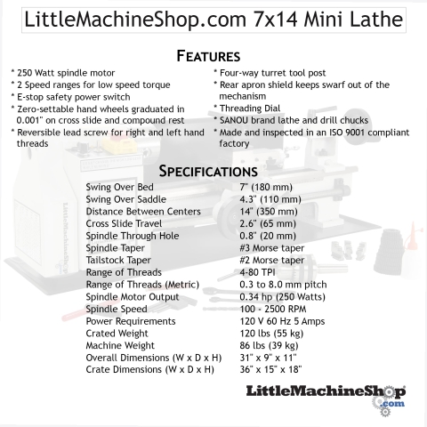

Swing Over Bed 7" (180 mm)
Swing Over Saddle 4.3" (110 mm)
Distance Between Centers 14" (350 mm)
Cross Slide Travel 2.6" (65 mm)
Spindle Through Hole 0.8" (20 mm)
Spindle Taper #3 Morse taper
Tailstock Taper #2 Morse taper
Range of Threads 12-52 TPI
Range of Threads (Metric) 0.3-8.0 mm pitch
Spindle Motor Output 0.34 hp (250 Watts)
Spindle Speed 100 - 2500 RPM
Power Requirements 120 V 60 Hz 5 Amps
Crated Weight 120 lbs (55 kg)
Machine Weight 86 lbs (39 kg)
Overall Dimensions (W x D x H) 31" x 10" x 12" (800 mm x 260 mm x 300 mm)
Crate Dimensions (W x D x H) 36" x 15" x 18" (910 mm x 380 mm x 450 mm)

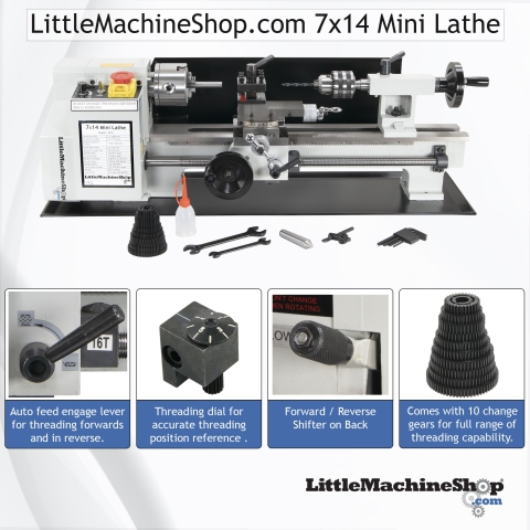

LittleMachineShop.com 7x14 Mini Lathe - features callout Features at a Glance

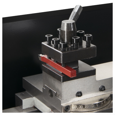

LittleMachineShop.com 7x14 Mini Lathe - cutting bit mounted in tool post Cutting Bit Mounted in Tool Post

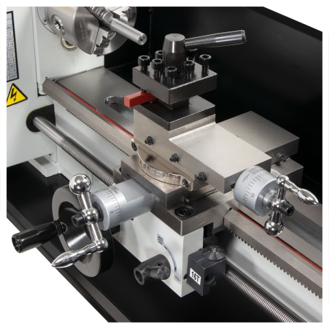

LittleMachineShop.com 7x14 Mini Lathe - cross slide and carriage Cross Slide and Carriage
LittleMachineShop.com 7x14 Mini Lathe - cross slide dial Cross Slide Dial

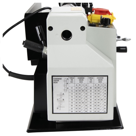

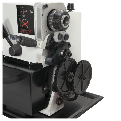

LittleMachineShop.com 7x14 Mini Lathe - side view Side View with Change Gear Settings

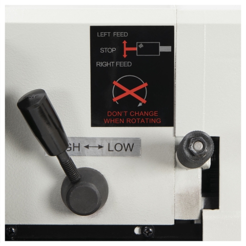

LittleMachineShop.com 7x14 Mini Lathe - hi-low shifter Hi-Lo Shifter
LittleMachineShop.com 7x14 Mini Lathe - gears Change Gears

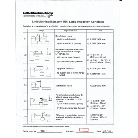

LittleMachineShop.com 7x14 Mini Lathe - factory inspection report Factory Inspection Report Included

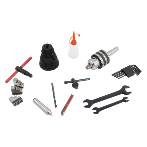

This Mini Lathe comes with the following:
  • Mini Lathe Users Guide
  • Factory inspection report on six key parameters
  • SANOU 3" (80 mm) 3-jaw self centering lathe chuck with two sets of jaws and a chuck wrench
  • A #2 Morse Taper (2MT) dead center
  • Threading dial
  • 1/2" SANOU drill chuck with 2MT arbor and a 6 mm drill
  • One 8 mm Brazed Carbide RH Turning Tool
  • 10-gear change gear set
  • Two open end wrenches
  • Four hex (Allen) wrenches
  • A plastic oil can
