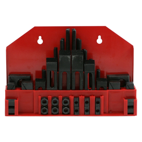

Clamping Kit, 7/16" T-Slot
  • Nuts fit 7/16" (12 mm) T-Slots
  • Stud thread: 3/8"-16
  • 58 Pieces
  • All parts are heat treated
  • Storage rack included
Part Number: 1144
Weight: 14.0 lb
$47.95 On Sale
Regularly $54.95
58-piece clamping kit 3/8"-16, 7/16" T-Slot.
This machinist clamping kit fits the 12 mm T-slots on the mini mill.
The T-slot clamp kit includes 24 3/8"-16 studs, 12 step blocks in pairs, 6 T-slot nuts, 6 flange nuts, 4 coupling nuts, and 6 step clamps.
Comes in a wall mount rack.
The stated dimension of the clamping kit is the width at the top of the T-slot.
Measure the width at the top of the T-slot as shown in the photo below. This is the dimension given for T-slot nuts and clamping kits. For example, if you measure 0.468 at the top of the T-slot, you should get a 7/16” (0.438”) T-slot nut or clamping kit.
