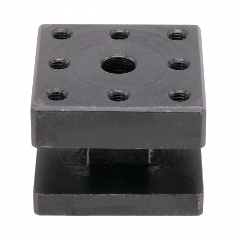

  • Four-position tool post for the mini lathe
  • 2" square and 1.5" tall
  • Tool slot is 0.64" tall and 0.32" from the bottom
Part Number: 1204
Weight: 0.96 lb
Price: $22.65
Four-position tool post for the mini lathe.
This is the tool holder that comes on the mini lathe. On most mini lathes it is the correct size for 5/16" tools. On "early" Homier and Cummins lathes it is the correct size for 3/8" tools.
The tool holder is 2" square and 1.5" tall. The tool slot is 0.64" tall and is 0.32" from the bottom.
For the cheapest quick-change tool holding system you can buy, simply purchase several of these.
We also carry the screws for this toolholder.
