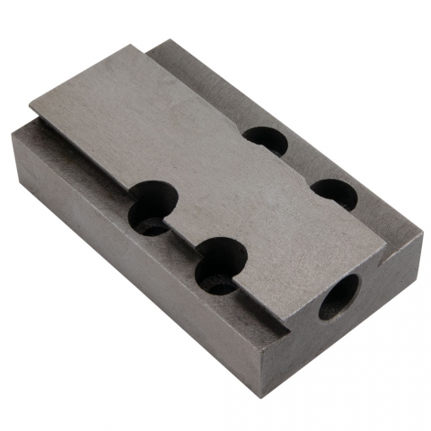

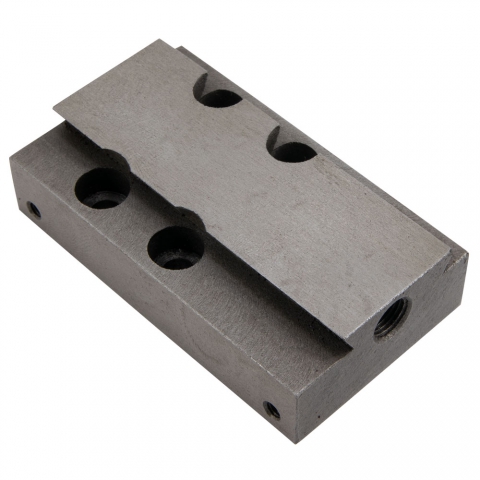

  • Pre-drilled compound rest bottom, mini lathe
  • Extra holes to eliminate chatter
  • For lathes with a 1 mm thread pitch, 0.0394" per revolution
  • Use with dial having 40 divisions
  • Fits numerous SIEG C2 and C3 and HiTorque mini lathes
Part Number: 1677
Weight: 1.00 lb
Price: $36.27
This is the bottom half of the compound rest on the mini lathe.
This part has a second set of holes that moves the center of rotation of the compound rest to help eliminate chatter.
Use the holes nearest the end of the part.
The thread pitch is 1 mm so the compound advances 0.040" (actually 0.0394") per revolution. Use with a dial that has 40 divisions.
See compatibility tab for reference to machines or other related products that use this product. See Used On tab for reference to machines using this part and the corresponding drawing number.
We offer two compound rest bottoms modified to J. W. Early's design.
Parts 1677 and 1880 have a second set of holes that move the pivot of the compound rest which helps to cut down on chatter.
Parts 1777 and 1881 has the second set of holes, but is also about 1/4" thinner than the standard part.
