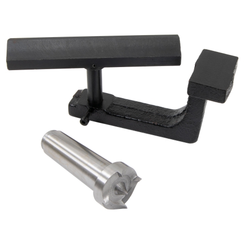

  • Turn wood on a metal lathe
  • Includes woodturning tool rest and spur center
  • Fits several SIEG mini lathes classes from C2 to SC4
  • Fit LittleMachineShop.com HiTorque mini lathes and bench lathes
Part Number: 1685
Weight: 2.40 lb
Price: $65.95
The wood turning tool rest clamps into a standard tool post so you can turn wood on your mini lathe or bench lathe. The tool rest height can be adjusted and it can rotate 360 degrees.The spur center fits in the lathe spindle with a #3 Morse taper. Mount the tool in a standard tool post by securing the shelf with the three set screws on the tool post. The spur center secures directly in the spindle with the chuck removed.
The wood turning tool rest clamps into a standard tool post. Install tool rest in tool post as shown. Tighten cap screws securely.
The spur center fits in the lathe spindle. The spindle must be a #3 Morse taper for proper fit.
Overall Length (Including Tool Rest) 6.75" (171.4 mm)
Length (Tool Post to Center of Rest) 3.62" (92.1 mm)
Tool Rest Length 5.25" (133.3 mm)
Tool Rest Height (Thickest Side) 0.625" (15.88 mm)
Tool Rest Depth 0.75" (19.0 mm)
Spur Center Overall Length 3.50" (88.9 mm)
Spur Center Taper #3 Morse Taper
"Wood Turning Tool Rest and Center M4 set screw and tool rest post
"Wood Turning Tool Rest and Center Mounted on a standard tool post
"Wood Turning Tool Rest and Center Securely mounted with tool post
