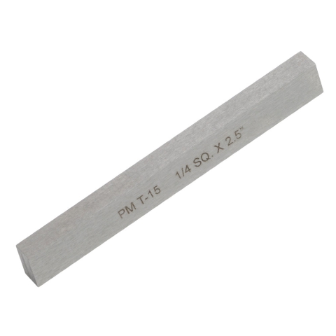

Tool Bit, 1/4" x 2-1/2", T-15 HSS, A R WarnerMade in United States
  • 1/4 square 2-1/2 inch long
  • T-15 High Speed Steel
  • American Made
Part Number: 1717
Weight: 0.05 lb
Price: $13.95
1/4" Square 2-1/2" Long HSS Tool Bit.
These are American-made tool bits made of T-15 high speed steel.
Make sure you get the correct inserts for your indexable turning tools.
Our chart of indexable inserts shows which inserts to use with each of our indexable tools.We carry both imported tool bits made of M2 high speed steel and American-made tool bits made of T-15 high speed steel from the A. R. Warner Co.
AISI T-15 provides excellent wear resistance and good hot hardness.
Typical Chemistry
Carbon 1.60%
Manganese 0.30%
Chromium 4.00%
Vanadium 4.90%
Silicon 0.30%
Tungsten 12.00%
Cobalt 5.00%
Sulfur 0.06%
Typical Hardness
Rc 65-68
This product works with lathes with a 0.25 to 0.38 inch tool bit size including:
