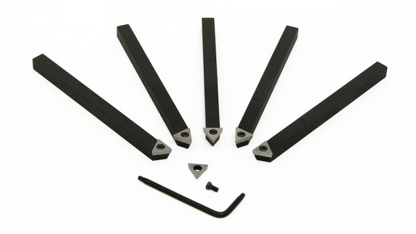

Turning Tools, 1/4" Indexable, 5 Piece Set, A R Warner
- 5 piece turning tool set
- 1/4" square shank 3.5" overall length
- 6 screws included
- T-7 wrench
- TPMW1.81.51 HSS inserts
Combine the advantages of high speed steel cutting tools with the convenience of indexable tooling.
The kit contains the following:
5 bars 1/4 inch shank 3.50 inches overall length
6 T-15 HSS TPMW1.81.51 Inserts
Relief : 11 degree, IC: 0.218 inch, Thickness: 0.093 inch, Hole: 0.110 inch Top opening: 0.146 inch at 60 degrees, Radius: 0.015 inch
Screws: (6) CO-2205
Wrench: T-7
