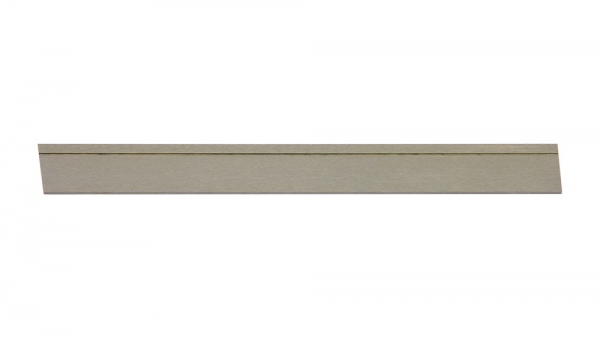

Cut-Off Blade, P1, M2 HSS
- This blade is size P1
- High speed steel
- Width: 1/16", Height: 1/2", Length: 4-1/2"
Our Lathe Cut-Off Blade is made with M2 high speed steel, ensuring a long-lasting and reliable performance. It measures 1/16" x 1/2" x 4-1/2" and is perfect for all your lathe cutting needs. Its size P1 makes it ideal for precise cuts. These blades are considered T-Shaped and provide great side clearance while the M2 high speed steel provides excellent wear resistance. Whether you're a professional machinist or a DIY enthusiast, you can trust in the quality of our Lathe Cut-Off Blade for all your machining tasks.
This is a premium American-made M2 high speed steel cut-off blade from the Arthur R. Warner Co.
The Arthur R. Warner Co. is a family-owned American manufacturer of high speed steel products with specialization in cutting, shaping, pre-grinding, heat treating, and finish grinding of premium grades of flat high speed steel. Their quality is excellent and LittleMachineShop.com is proud to carry their products.
Chris' TipsSize P1 blades are 1/16" wide and are the most commonly-used size. P1N blades are 0.040" wide. These thinner blades are good for small work. P1X blades are 5/64" wide. Use these thicker blades for parting off larger diameters where you need additional stiffness.
