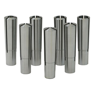

  • Set of seven 2 Morse taper round collets
  • Overall length is 2.67" (68 mm)
Part Number: 1752
Weight: 1.11 lb
Price: $79.95
Set of seven #2 Morse taper round collets in sizes 1/8 - 1/2" by 16ths.
Made of high grade tool steel these collets have been hardened and ground to close tolerance.
Set includes sizes: 1/8", 3/16", 1/4", 5/16", 3/8", 7/16", and 1/2".
Collets are made from high-grade tool steel and are precision ground and hardened.
The drawbar thread is 3/8"-16 and the overall length is 2.67" (68 mm).
You might need to a make or purchase a drawbar to work with these tools.
Hole Diameter 1/8~1/2" by 16ths
Drawbar End 3/8"-16
