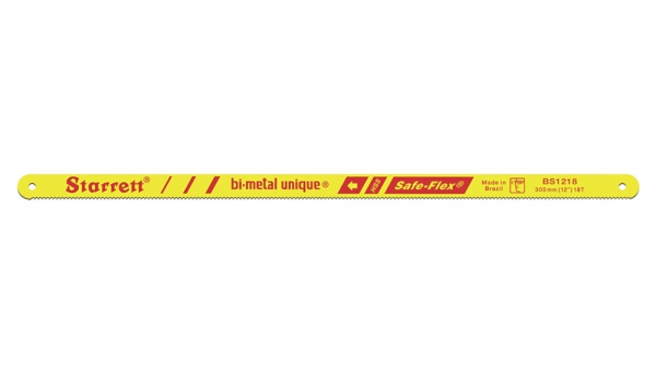

  • Starrett bi-metal uniqueHSS Safe-Flex hacksaw blade
  • 12" X 1/2" X .025" (300mm X 13mm X 0.65mm)
  • 18 TPI (Teeth per Inch)
  • Starrett catalog number BS1218
  • Sold Individually
Part Number: 1850
Weight: 0.04 lb
Price: $2.26
This metal hacksaw blade is 12" long, 1/2" wide, and has 18 teeth per inch. The blade is 0.025" thick.
Starrett unique high speed steel Safe-Flex 18 inch bi-metal hacksaw blades are made with a patented solid-state diffusion process with 170% more HSS weld area and ground teeth for reduced blade fracture, faster cutting and longer life.
