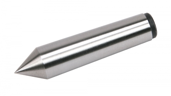

Dead Center, 2MT Short
- Solid 2 Morse taper dead center
- 60 degree included point angle
- 0.708" (18 mm) diameter
- 3.09" (78.5 mm) overall length
This center fits the tailstock of the mini lathe. This center is made from hardened steel and ground for accuracy. The point is a 60ยบ included angle.
The shorter length is designed for the smaller 7x10, 7x12 styles lathes.
Chris' TipsUse this to turn between centers, using a live center in the tail stock, and a lathe dog to drive the part.
This product works with lathes with a 2 Morse taper spindle taper and a 2 Morse taper tailstock taper and a short 2 Morse taper tailstock taper including:
