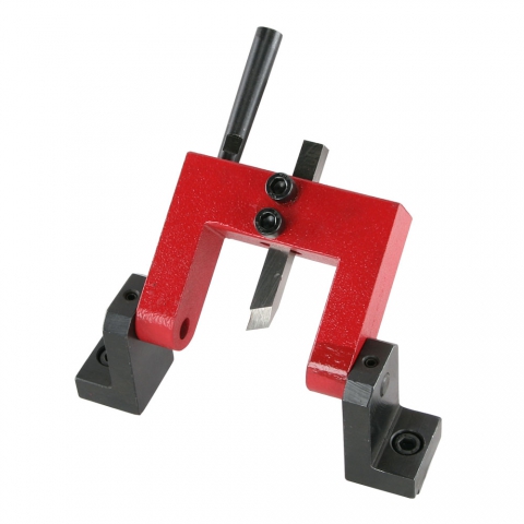

Ball Turning Attachment
- Turn balls on metal mini lathe
- Cut convex curves up to 2" in diameter
- Includes one presharpened 5/16" tool bit
- Fits most SIEG and LittleMachineShop.com HiTorque mini lathes
- Mounting block not included
This attachment allows you to turn balls on the mini lathe.
This radius turning tool will cut convex curves up to 2" in diameter.
Includes one presharpened 5/16" tool bit.
You must make a mounting block for the ball turning attachment.
See Chris' tips for plans for the mounting block.
See the Compatibility tab for machines and other products that work with this product.
Chris' TipsHere's a photo of it on a lathe.
