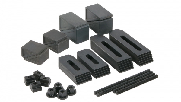

Clamping Kit, 8 mm T-Slot, 24-Piece
  • Four M6 studs
  • Four T-slot nuts for 8 mm T-Slots
  • Four flange nuts
  • Four step clamps
  • Four step block pairs
Part Number: 1972
Weight: 3.31 lb
Price: $39.85
20-piece clamping kit
This clamping kit fits the 8 mm T-slots on micro mills.
The clamping kit includes 4 M6 studs, 4 T-slot nuts, 4 flange nuts, 4 step clamps, and 8 step blocks in pairs.
The stated dimension of the clamping kit is the width at the top of the T-slot.
Measure the width at the top of the T-slot as shown in the photo below. This is the dimension given for T-slot nuts and clamping kits. For example, if you measure 0.468 at the top of the T-slot, you should get a 7/16” (0.438”) T-slot nut or clamping kit.

Nominal Sizes for 8 mm T-Slot Nut
8 mm t slot nut
This product works with mills with a 0.315 inch T-slot width including:
  •   Prazi BF400 Mill
  •   Prazi BF450 Mill
  •   SIEG X1 Micro Mill
  •   SIEG SX1 Micro Mill
  •   SIEG SX1P Micro Mill
