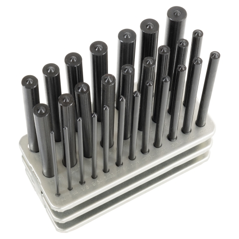

  • 28 piece transfer punch set
  • Sizes from 3/32" to 1/2" by 1/64" plus a 17/32" punch
  • Heat treated and tempered tool steel for long life
  • Transfer punches are 0.0025" undersize
Part Number: 2031
Weight: 3.68 lb
Price: $19.95
These transfer punches are 4-7/8" long and have a black oxide finish.
The precision punch set includes an indexed stand.
The punches are 3/32" to 1/2" diameter in increments of 1/64", plus a 17/32" punch.
