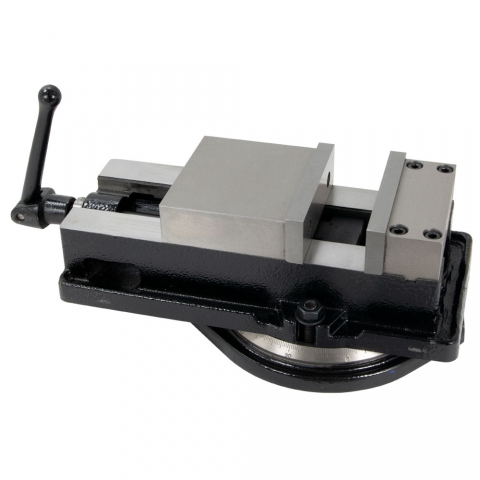

  • Precision 5" Kurt-style milling machine vise with swivel base.
  • Ground surfaces.
  • Jaws hardened and ground.
  • Fixed jaw is bolted for enhanced rigidity.
  • Detachable swivel base features easy to read divisions.
Part Number: 2061
Weight: 47.2 lb
Price: $249.95
PayPal Credit
Heavy swivel base vise for precision milling.
The top, bottom of vise bed, gib, jaws, swivel base, and all plate mounting surfaces are ground. The jaws are hardened and ground. The fixed jaw is bolted from the top for enhanced rigidity.
The jaws are 5" wide, 1.58" deep and open 5.71".
Without the swivel base, the ways of the precision milling vise are parallel to the base of the vise within 0.0006" in 4". The jaws are perpendicular to the ways within 0.002" in 4". With the swivel base installed, the ways of the vise are parallel to the base of the vise within 0.0008" in 4".
Jaw Width 5" (127 mm)
Jaw Depth 1.58" (40.1 mm)
Maximum Jaw Opening 5.71" (145.0 mm)
Swivel Base Yes
Weight 47.2 lbs (21.5 kg)
Height with Base 5.12" (130.0 mm)
Height with Out Base 3.94" (100.1 mm)
Length 14.8" (376 mm)
Width with Base 8.7" (221 mm)
Width with Out Base 5" (127 mm)
Ways Parallel to Bottom of Vise Within 0.0006" in 4" (0.015 mm in 100 mm)
Ways Parallel to Bottom of Swivel Base Within 0.0008" in 4" (0.020 mm in 100 mm)
Jaws Perpendicular to Ways Within 0.001" in 4" (0.03 mm in 100 mm)
