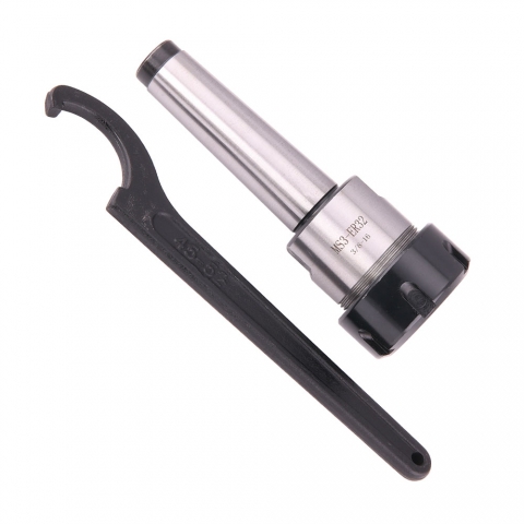

  • 3MT to ER-32 collet chuck
  • Spanner wrench included
  • Drawbar thread is 3/8"-16
Part Number: 2231
Weight: 1.75 lb
Price: $45.95
ER-32 collet chuck for the mini lathe and mini mill. The shank is 3 Morse Taper to fit the spindles of the mini lathe and mini mill.
A spanner wrench is included. The drawbar thread is 3/8"-16.
ER-32 collets have a range of 1/16" to 13/16" (1.0 mm to 21.0 mm).
*With all ER collet chucks, the collet must be snapped into the nut before placing it into the chuck. (see Chris's Tips for more info)
You might need to a make or purchase a drawbar to work with these tools.
This product works with lathes with a 3 Morse taper spindle taper including:
